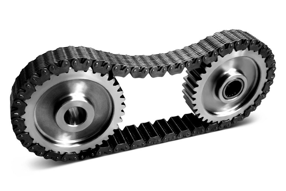

    Not enough info to say for sure. But if you hear a popping noise when in 4X4, especially when accelerating it could be a stretched drive chain inside the transfer case. If the truck has been used in 4X4 when on a surface with good traction it puts the chain under stress. It stretches and will slip on the cogs and make a popping noise. It does it most often when you accelerate from a stop. Once up to speed it will go away.
    This is inside the transfer case.
    A lot of folks think, and even post here and on other sites, that it is OK to drive in 4X4 on pavement. They think that just because their truck didn't blow up at the moment they aren't doing any damage. It just takes time for it to show up.
