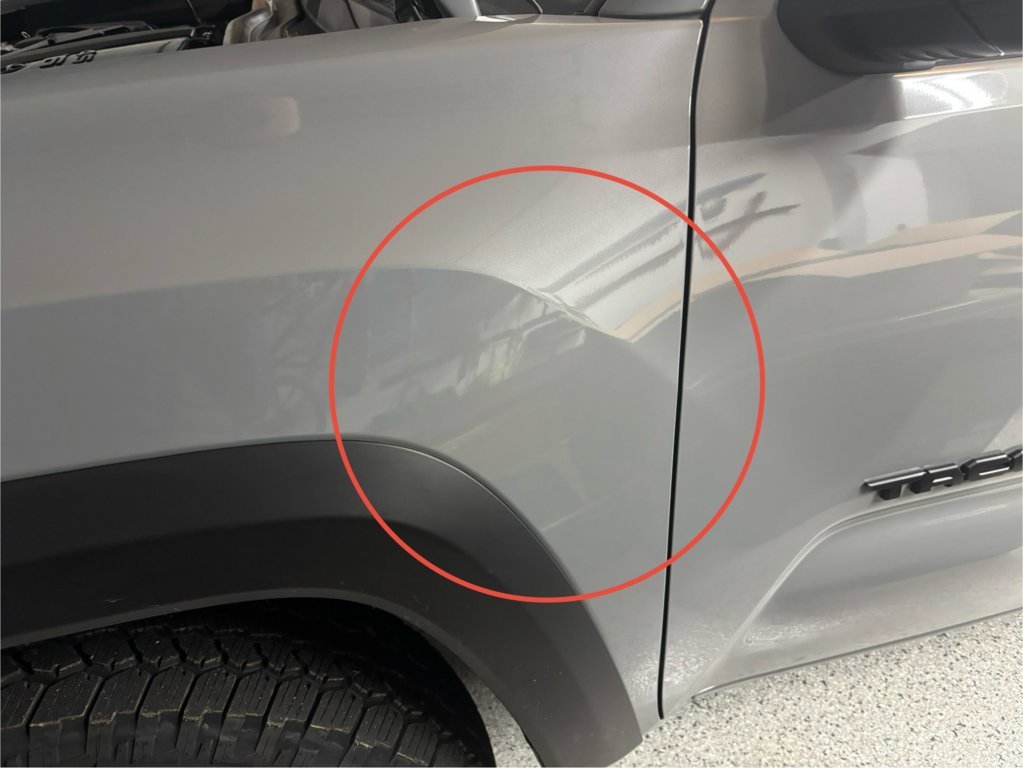

    What’s behind here, and how can you access that space? I’m contemplating a shore power connection here, but don’t want to start digging behind the wheel well liner if someone already has the answer.

    There's a tall styrofoam piece running the height of the fender. You can see it if you open the driver's door and look toward the front. Other than that, nothing. Access is by peeling back the plastic fender liner (and destroying a few plastic clips in the process).

    ^May be a good idea as the fender is tinfoil and can dent with repeated plugging/unplugging.

    If the fender is that weak, an alternative may be to mount it to the side of an aftermarket bumper. This is what I had done on my 1st gen, but I don't have an aftermarket bumper on my current Taco.

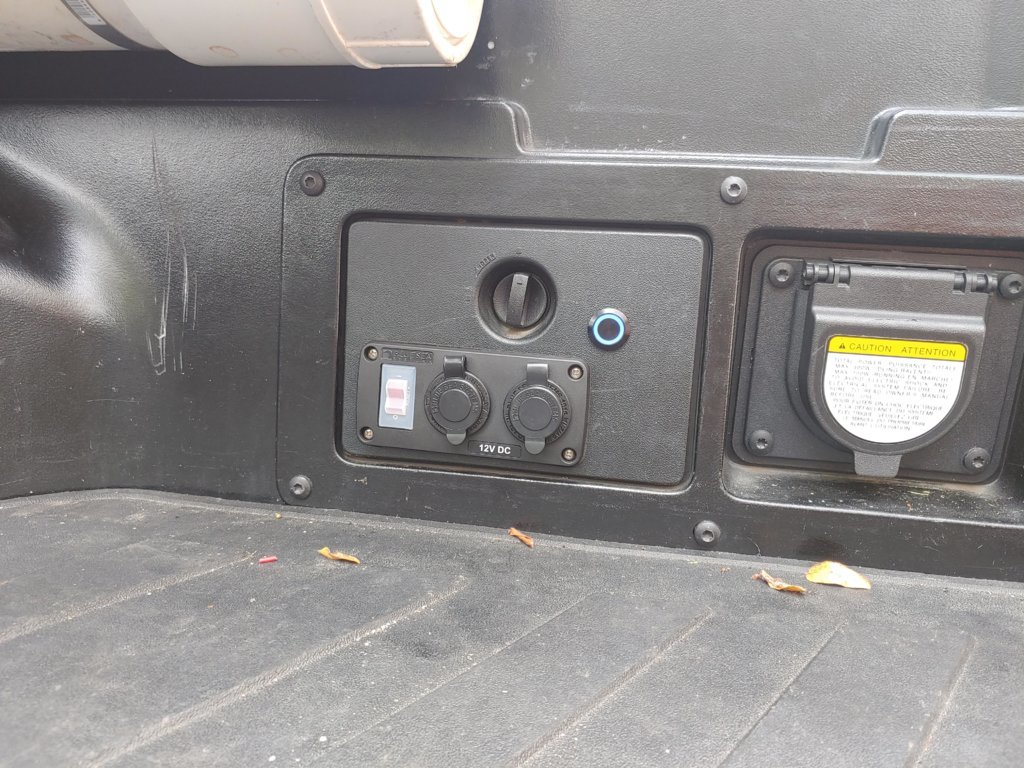

    I have a shell on the truck, so that'd be a hassle to access every time I wanted to plug in or unplug the truck. (Thanks, @Hodakaguy!)
