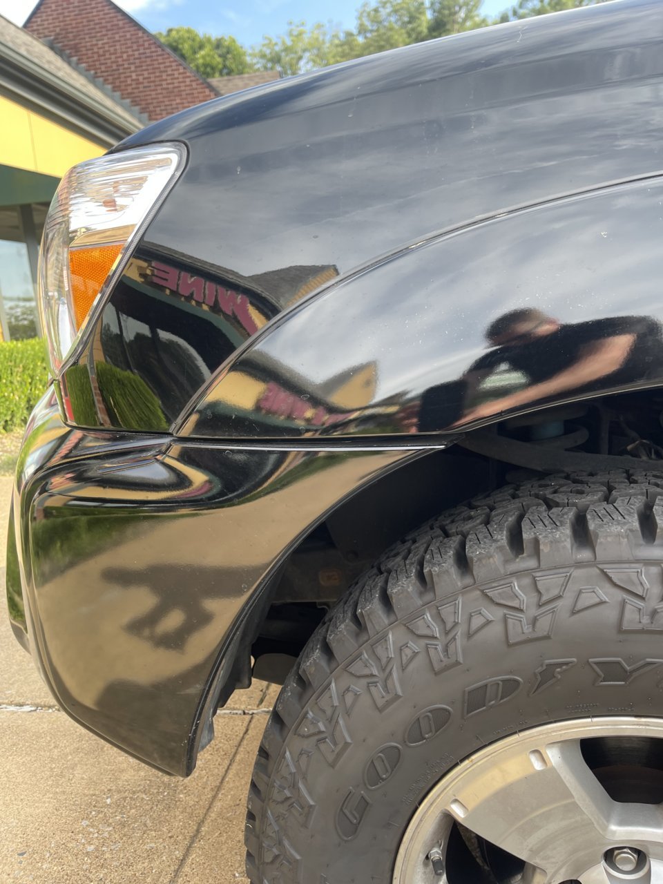

    Hello hello,
    I’m looking for any insight on how to tighten up the gap between the fender and front end. Thanks!

    Looks to be a bumper issue.

    I have that same issue with my 2011 and I bet other people will chime in. Also, I believe it's just a clips being worn

    think you can either tighting up the bolt, or replace the screw with a zip tie and a small nylon washer. been a while since my Tacoma had an oem bumper

    When I had my white 2014, I got tired of muddy water getting kicked up and running out of there. I eventually masked a line above and below that gap and filled it with black RTV. Problem solved.

    Pretty standard gap. That piece come off the bumper. There’s not much adjustment to it.
