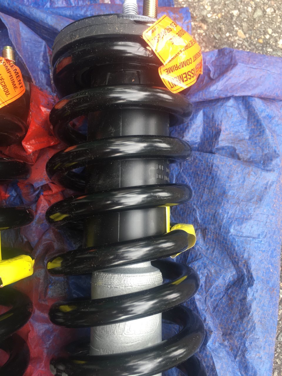

    Ok. So the final general consensus seems to be that installing a decent coilover, that is stock length, 18.4 (4600’s) into a space in which the recommended length is 20.25 is all good. Correct?

    I have not found OEM measurements. I am going off what other suppliers, bilstein, Monroe, KYB, etc, state as OE or OEM. They come in pretty close to each other, give or take.
    I would be interested in what someone else has come up with. Of course why, if stock, would someone bother measuring. This was my case until I started having issues.

    I can not find assemblies that are the same ride height as factory.
    I've tried 3 different venders assemblies and they are all giving me a 1.5" less ride height than factory!
    My next try is to install 4 runner assemblies.

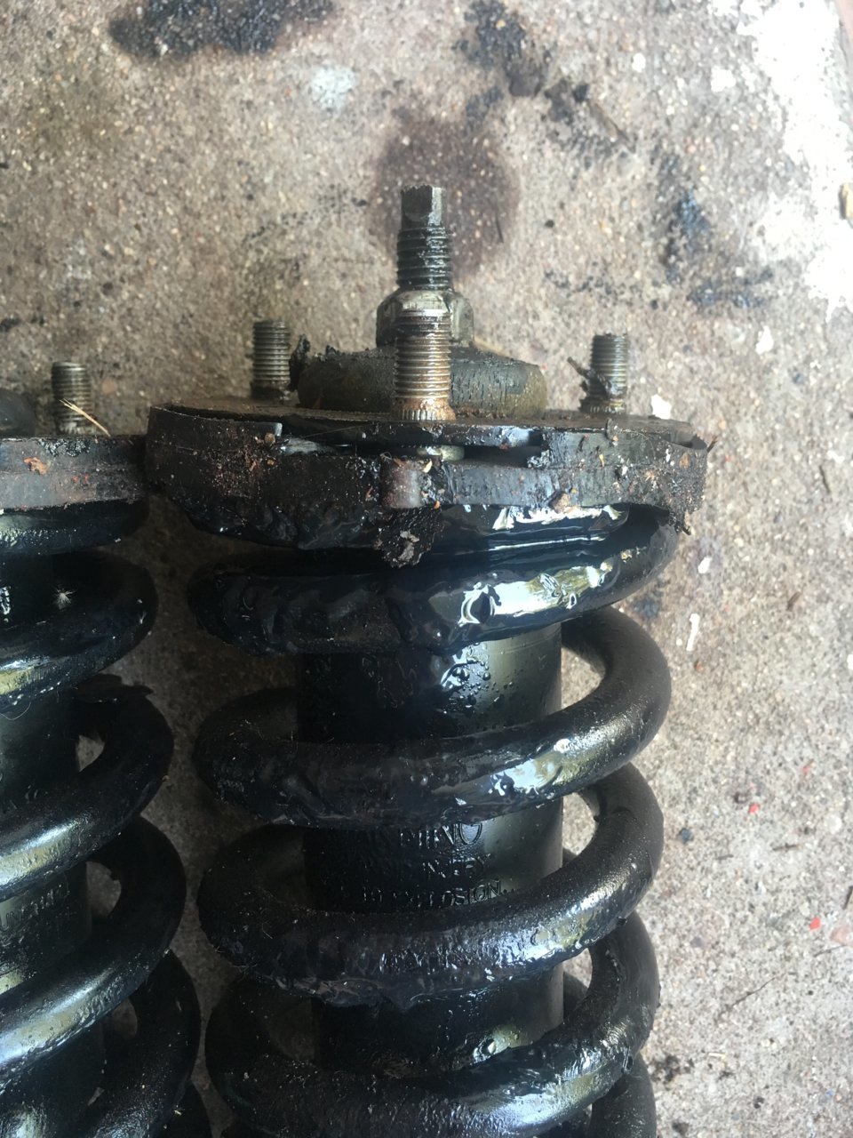

    Measuring fender to ground with original, factory springs, with worn craptastic Monroe shocks.
    New, quick assemblies installed resulted in a ride height that is 1.5" lower. I've tried 3 different suppliers. Hence my next attempt will be with 4 runner assemblies.
    FWY, the original springs had been on 2 different Tacoma V6 4 x 4 excab trucks. Roughly 400k miles and they still rode at normal height.
