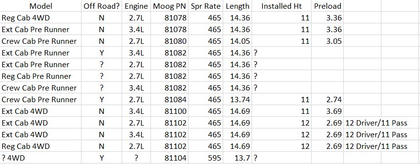

    Apparently General Spring does have some coils, just not for the Tacoma. I think the main issue people are having is an incorrect spring for the application. For aftermarket, the best info out there is on the OME springs, which do say they would lift the front between 1"-2". Everything else you can find is all over the place, and getting the exact specs on the Quick Struts springs seems to be difficult.
    So, I checked out the Moog site, as the ones listed in a previous post got me thinking (but nobody has the the PN listed above in stock). They have no less than NINE different part numbers listed for a 2001 Tacoma. Now, some of them are going to be for the 5-lug, so I didn't go in to those details, but that leaves 7 for the 6 lugs. I tabulated the info below. Assuming that a Pre Runner is a 2WD 6-lug here. Note that some part numbers have the same spec (81100 = 81102, 81078 = 81082).
    Basically, if you have a 4WD non-TRD, you need the 465 lbs/in 14.69" springs. The Regular Cab 4WD with the 2.7L appears to be able to use it in a 14.36" length, but it is listed twice.
    If you have a 4WD TRD, they list a 595 lbs/in spring at a 13.7" length, but that seems weird. Although, assuming a similar installed length, that would have less preload and still give a bit of lift over the non-TRD, just seems like it might ride rough.

    Thank you! Interesting, because when I put my truck in I got 81101, 81102 & 81104.

    As I said earlier, don't bother measuring them. Obviously check the part numbers and make sure they're the correct ones. I can tell you the measurements are likely to be different between different brands or models. That doesn't mean something is defective or isn't compatible with your truck. As I expressed in my previous discussion on "equivalence" they're most likely not *exactly* the same. Especially the rear shocks. That are *going* to be different, probably be a few inches, because the 5100s are for a lifted application.
    The Moog coils are a good replacement too, if you can get them. But they aren't going to be much, if any better than the coils that are on your quickstruts. They're probably made in the same factory, lol...
    If you like the option of a lift, then the 5100s are for you. At least for the front, you can leave them at stock height just fine. The rear 5100s, however, cannot. They are longer and you need at least an inch of lift for them to fit (although there is some debate on this depending on the exact part number, I believe some newer 5100 models might be able to be used at stock height - search for that discussion though, don't quote me on that).
    The 5100s are nice because you can make some gross adjustments in the height to suit your needs/wants.
    But as many of us have said several times, if you want to have full control over the ride height and ride quality of the truck to ensure you get *exactly* what you want and/or expect, you're going to have to spend $1000+ on front coilovers, plus another $500-$1000 on the rear shocks.

    The site has the 81102 as for "manual transmission, transmission trans". The 81101 is for "AT, Transmission Trans". The dif between them is the springs for the 02's have an inch difference, 11/12. Taco Lean. When I pointed out to the rep that AT's have this as well, he said he didn't know why they were marketed that way.

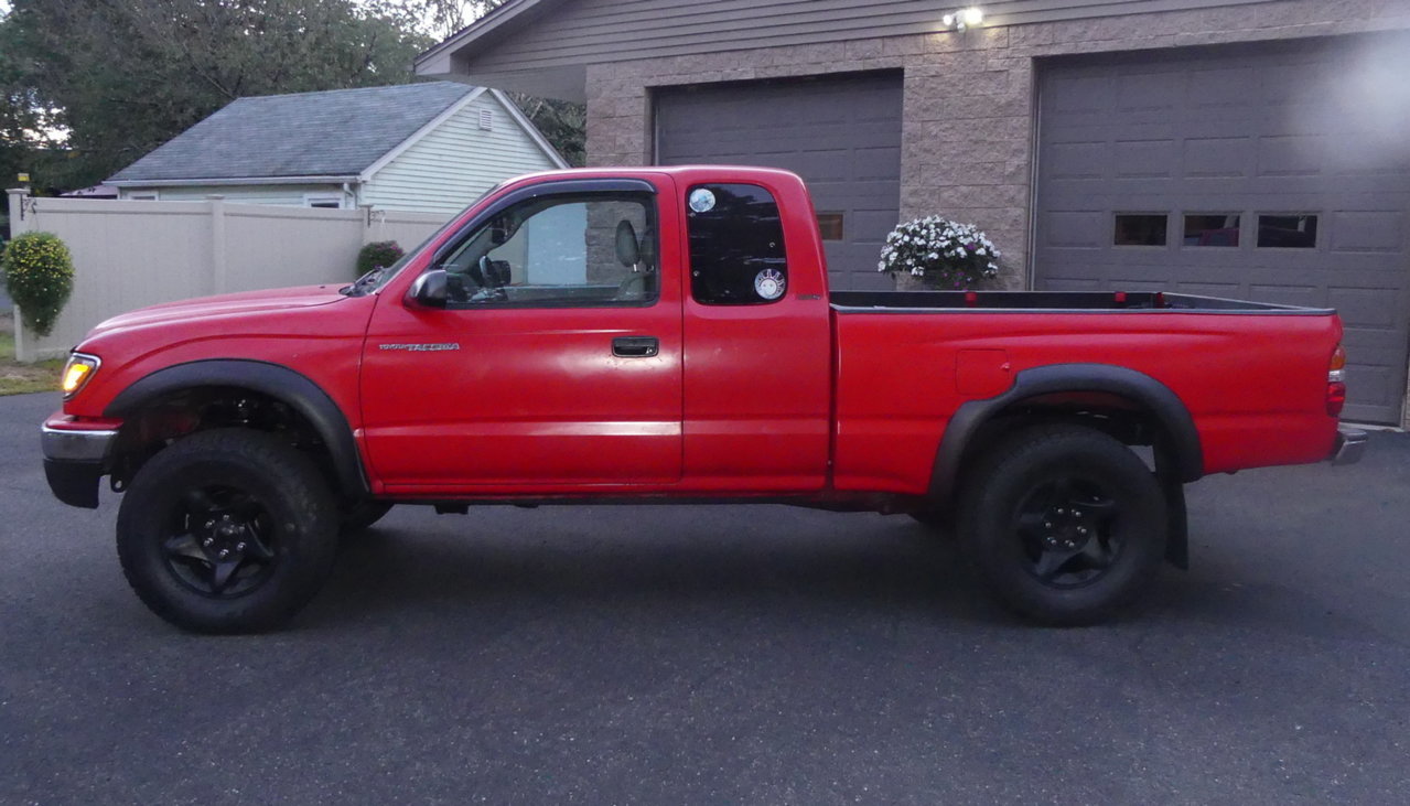

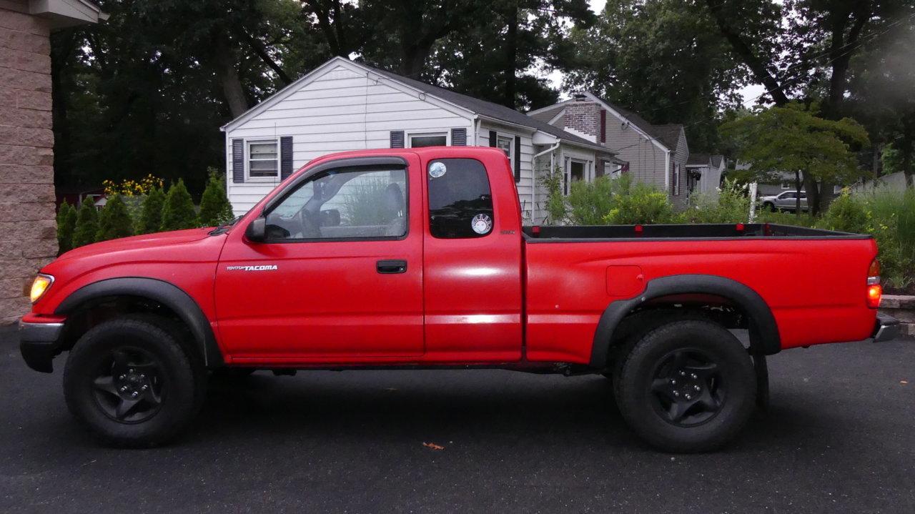

    Soooo.... Whilst I realize the "discussion" has run its course & then some, personally I get frustrated when I find a thread that pertains to what I am working on & :notsure:
    With the aid of my handy measuring tape & another member, we figured out I had been driving with no preload. 0, zilch, nada. So it was a good thing I did not continue to drive with those installed.
    The advice I did take was to get some 5100's & 880's. I called Wheelers & got a preassembled set for 407.00. I just got back on the road yesterday since other things needed to be taken care of, possibly collateral damage from the crappy coilovers.
    Anyway, wicked happy with the new ones. I may have to raise the butt end a bit, however that's for another day....
    Again. I am thankful for the helpful advice, as well as to those who took the time to explain....
    Before
    After

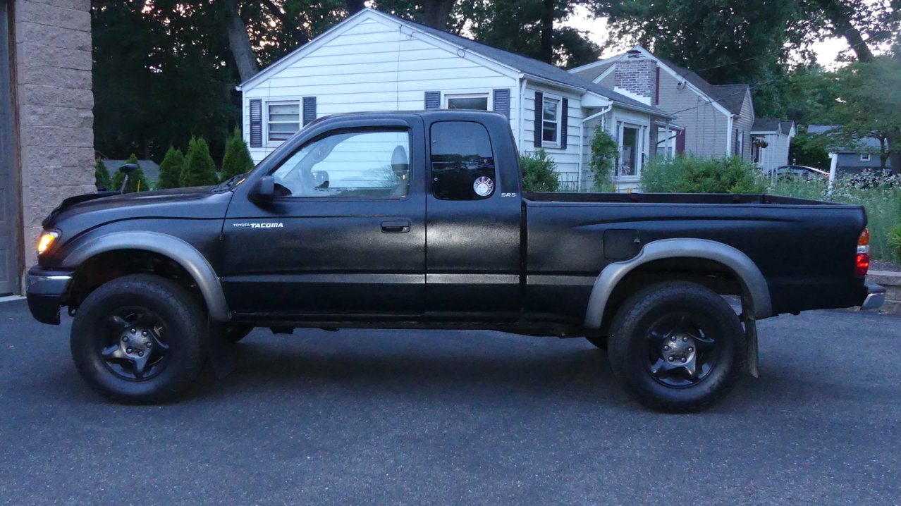

    Throwing an update in here since another member im'ed me asking how the coilovers (5100's & 880's) are working out. Haven't looked back :thumbsup:. I also swapped out the crappy rear monroes for KYB gas adjusts & that smoothed everything out....
    ABA180 and TACOTU3 like this.
