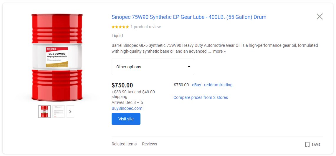

    Do you seriously think that Toyota is paying $7.50/qt for gear lube? Here's $3.40/qt without even trying:
    That's just enough to fill about 36 Tacos. They use over 6,500 times that per year, just on Tacos. Guaranteed they are paying less than $2/qt, which cuts at the penny pinching conspiracy theory.

    Ok fair point, I was totally guessing on price they pay, lol. Still though, not worried about any of this.
