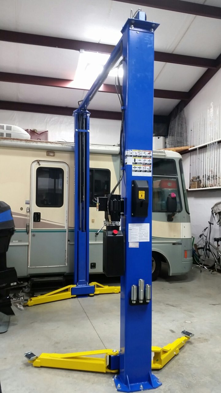

    I'm going to lift it on this, with the weight safely distributed, and go to work on it.

    Volt, I found that with my camper shell the center of gravity is roughly 2 inches back from that which Splitbolt shows in his illustration. To further dial in my lift safety I put an inclinometer on the lift and measured its deflection to insure the lift was balanced as I raised the truck. It showed only 0.2 degrees of deflection, so I am satisfied with my findings. For the same safety reasons I recommend that you take the time to weigh your own if you are going to be getting under it.

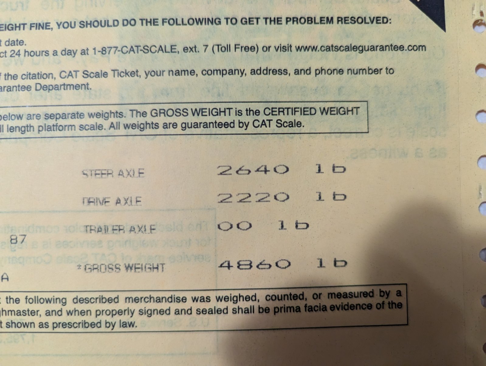

    Super old thread, but if anybody is interested. This is with a little over 3/4 tank of gas. 54/46.
