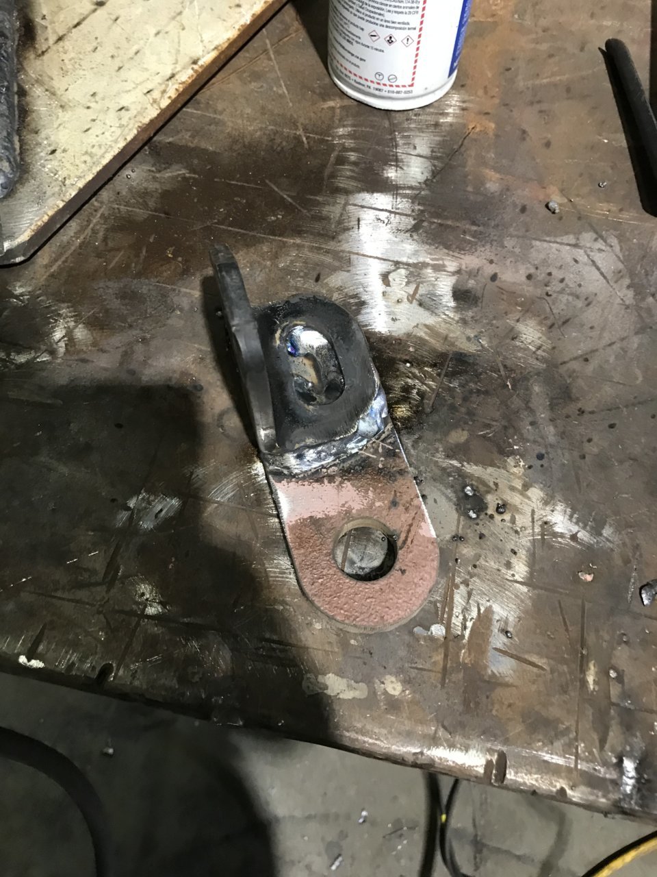

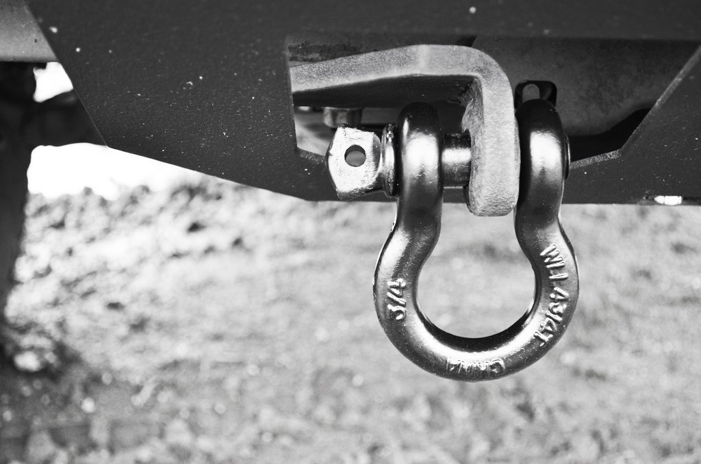

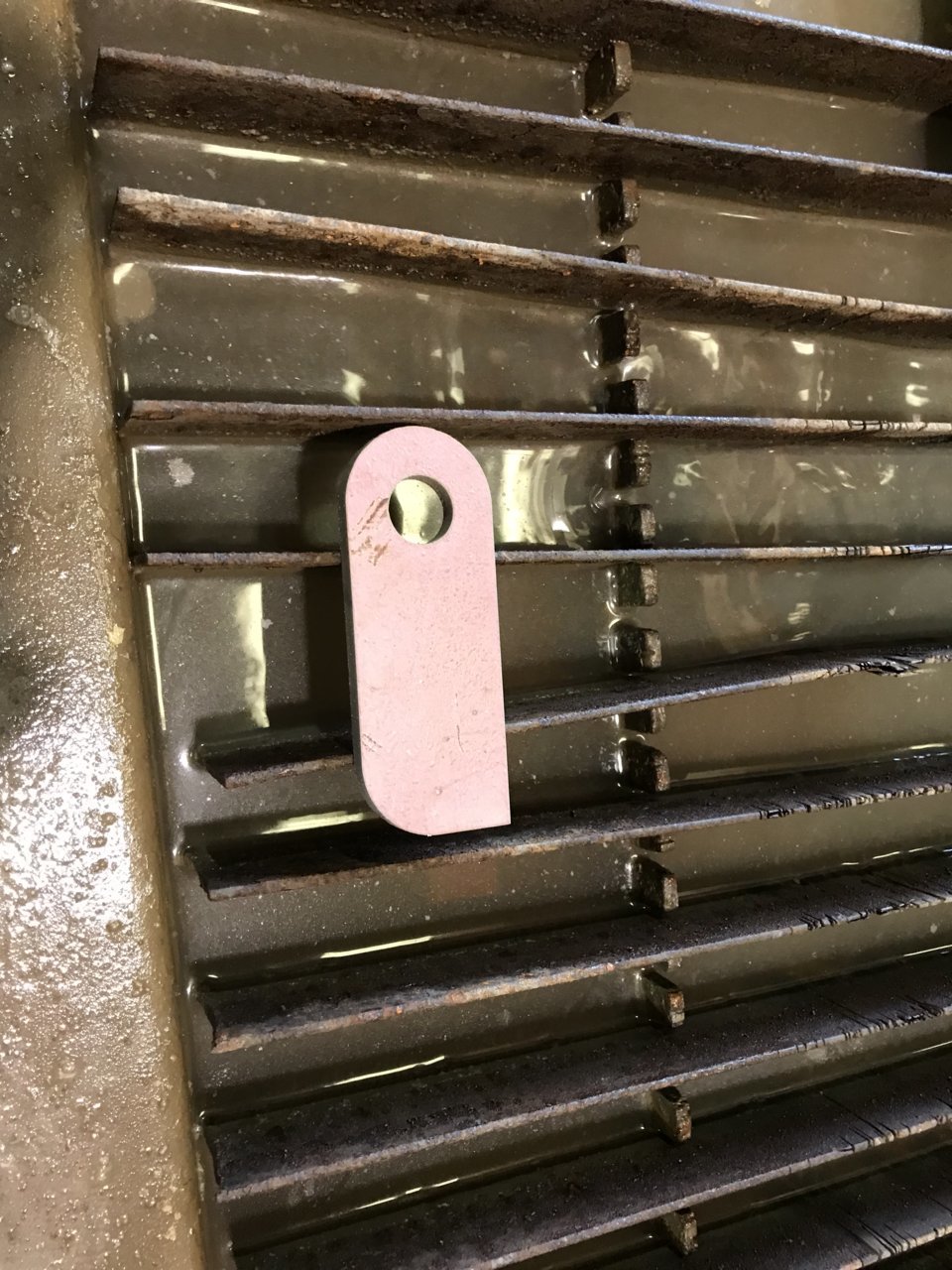

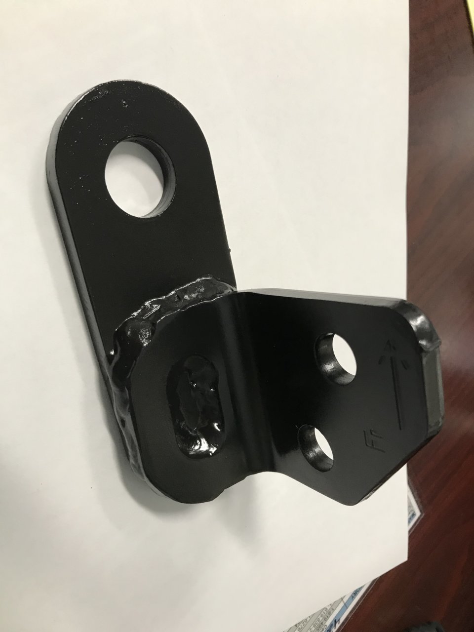

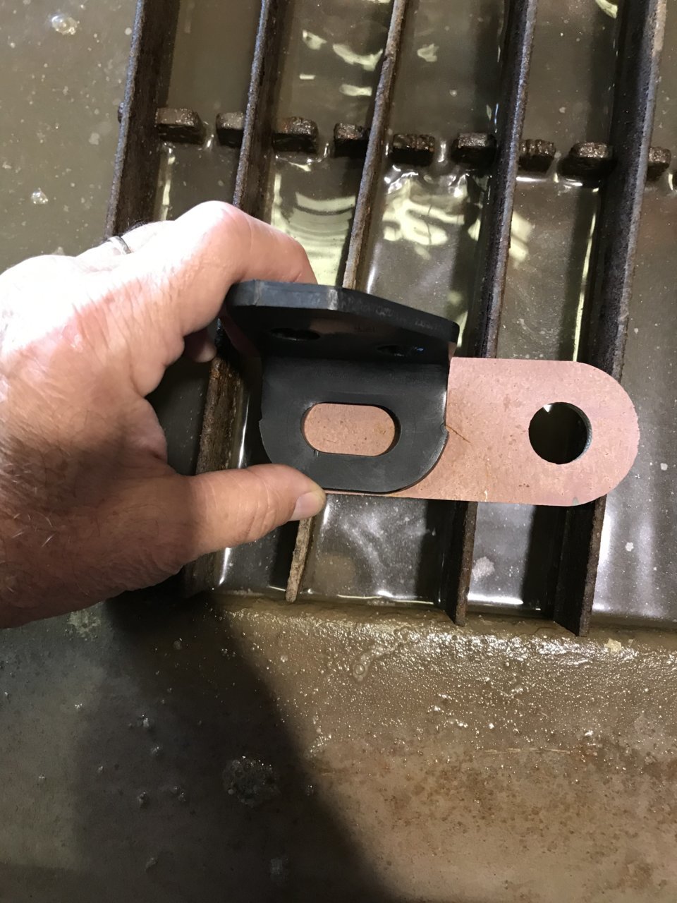

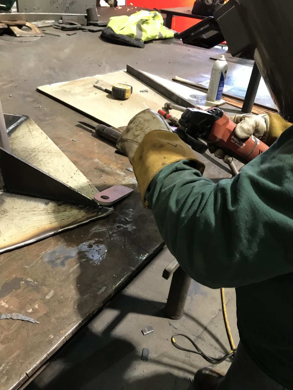

    Last Friday I had a near disastrous experience at a boat launch ramp due to exposure of heavy algae growth at low tide. I could not get traction no matter what I tried including low gear and switching to auto LSD. Almost jackknifed the trailer and almost went off the side of the ramp and into a rock pile. Had to be pulled out by a Chevy dully who was also having problems with traction. Long story short, our recovery point sucks and won’t accept anything greater than a 1/2” shackle. Today I modified my recovery point by extending it and adding a hole that will accept a 3/4” shackle. Used 5/16” plate rather than the stock 1/4”.

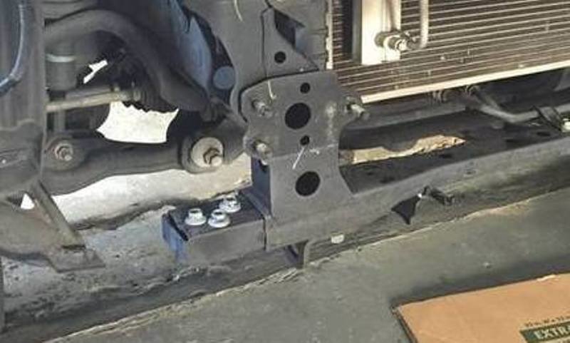

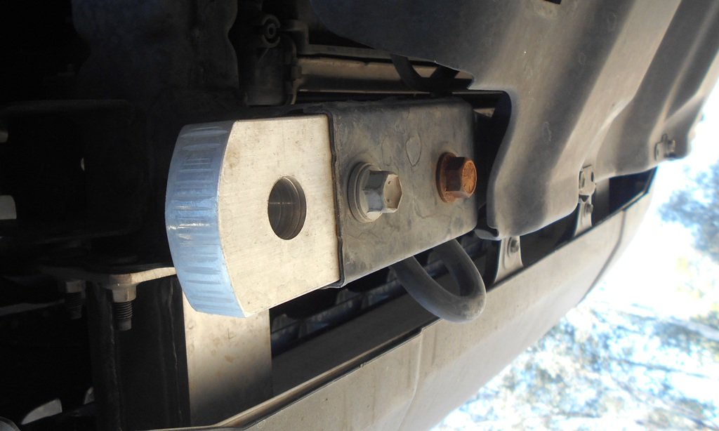

    I never could get myself to buy in to an anchor point that is hanging on bolts - to a nut tacked in side a sheet metal box. All of them I've looked at had "battle damage" from severe use - the nuts dimple out the sheet steel.
    This one won't come out without removing a big chunk of the skid x-member. It is 1.00 thick 6061T6 aluminum (35,000 psi yield strength) - but it could be steel.
    The whole front x-member is attached to the frame with a pair of four sided sheet metal boxes - with big holes on all four sides. The x-member appears to have been specifically designed to attach the leading edge of the factory skid plate.

    I can tell you - and others will attest to stuff similar this - that if you are for instance elk hunting (October), 10/15 miles back, near the wilderness area (Gros Ventre river road east of Jackson, Wyo comes to mind) and then it decides to snow 2-1/2 feet - unexpectedly........... there is no telling what sort of loads you will put on your truck - or trucks to eventually get out of there. Like hook three chained up outfits with horse trailers nose to tail - and use the little truck out front to "break trail" - (reeling it back in with the second truck's winch). Every possible attachment point is going to get a test. Every bit of recovery equipment you brought along - is going to get used. The "load rating" Toyota suggests for the front tie down points will never come to mind.

    Casper / Tucson
    014 Taco 4Dr 4wd
    Yep - I've been a mechanical engineer for over 40 years now. That's the reason I don't trust the stuff that just hangs on bolts stuck in the tacked in nuts. The ARB part looks like a useful item - just grossly over priced.
