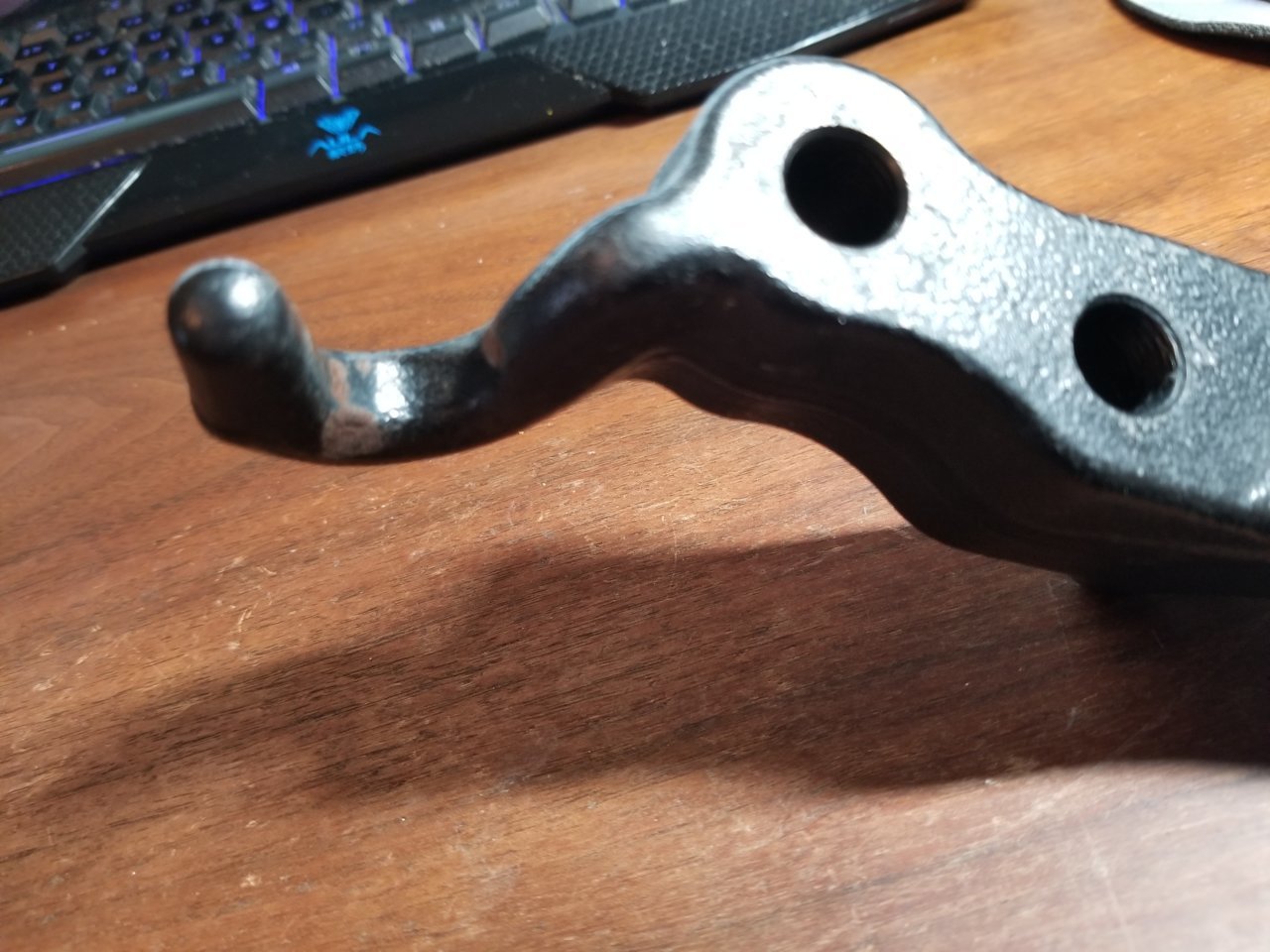

    I believe the little hook in the back is just for shipping tie-down point. When I removed my Front passenger hook for painting at 5000 miles, I noticed a rusty scuff mark on the small hook since they probably used it during original shipping.

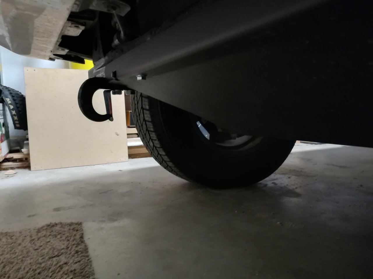

    I swapped my passenger side tie down bracket with this 10,000lbs load, closing hook.

    Yes, these are strictly shipping tie down points. I have (UNFORTUNATELY) had to use mine for a mild recovery... and it held... but it was a light tug while under constant tension... anything harder (lets say a good 'jerk') and this thing is a goner. Unfortunately aftermarket is crazy expensive. Might as well just save that $$$ towards a bumper with integrated tie points!
