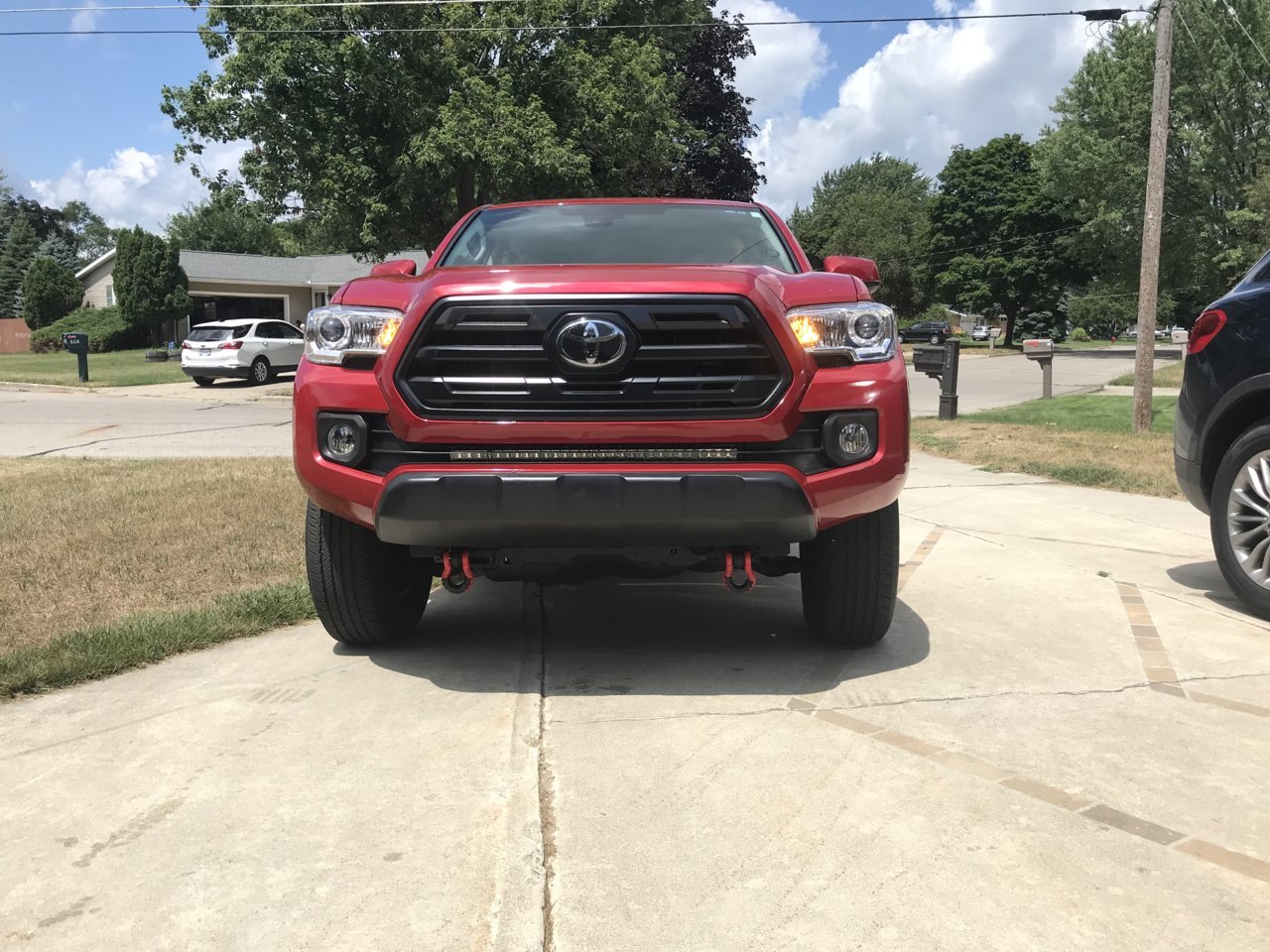

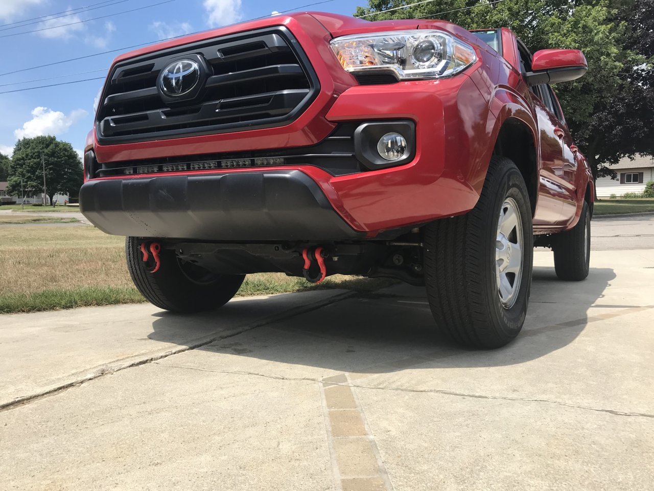

    I’ll see ho they work in a few weeks. I don’t go into deep stuff and I know when to stop digging. Here’s some more pictures for the few that asked2BF19853-7C37-4562-B816-F18038B794AD.jpg8C935AC7-5B5F-430C-802F-4FD8C669B190.jpg8C935AC7-5B5F-430C-802F-4FD8C669B190.jpg

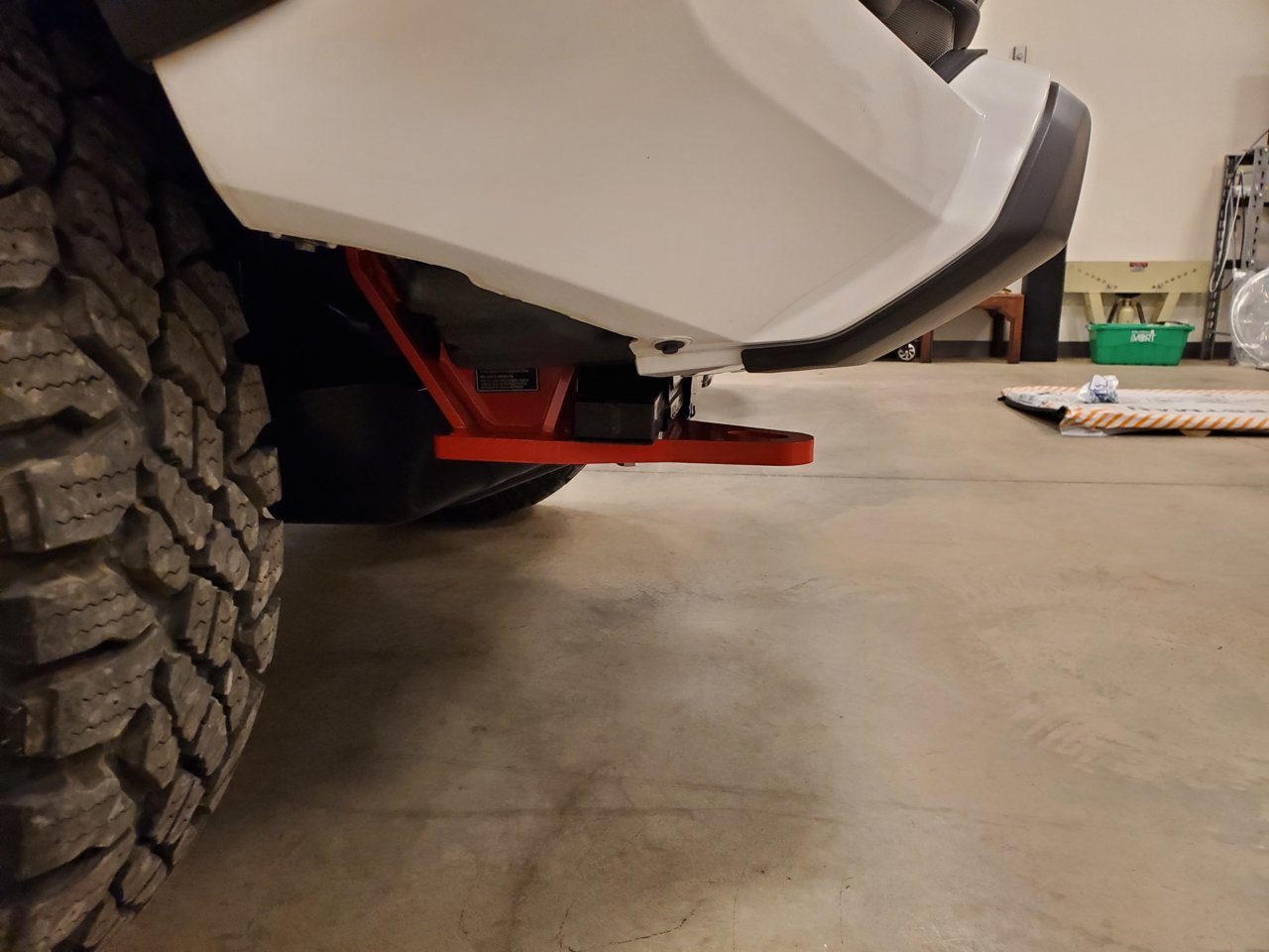

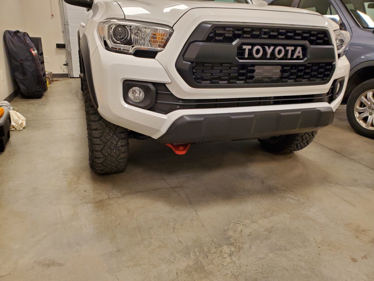

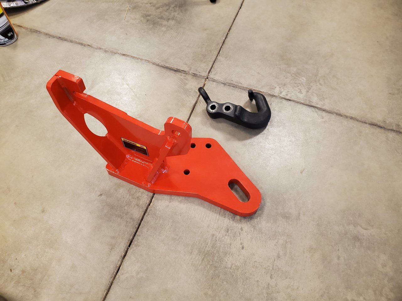

    The only true recovery point I as able to find for my '19 OR was the ARB. It's rated to 18K lbs. Weighs 17 lbs. Here are a couple pics. 20200826_193549.jpg 20200827_215235.jpg 20200827_215304.jpg

    I was meaning spinning my tires and digging myself into a rut/hole. With 2wd, once you start spinning the tires just stop and get pulled out. (My truck is 2wd)

    There easy to install and look good. I haven't been able to go off-roading since i put them on so that's all I got for now.

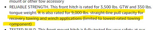

    Seems like it should be fine for most recoveries. It just sits pretty low on the front and would limit your clearance. Depends on what you plan on doing with it.

    I highly recommend the ARB front Recovery Point. Not only it has straight line pull but also rated for full turn pull (not to exceed turn angle of each tire).
    Please be aware the differences of a Recovery Point vs a Tow Hook.

    The one liability I see with the ARB unit is that it is only a single side. A single frame member. And anyone can see there is scant material to attach to in the Factory frame, regardless of the additional attach points.
    That Curt hitch is looking pretty good. Only four bolts, But spread wide, and in line with the frame rails. ;-)

    Just so people are aware. The ARB recovery point is awesome, strong, and load rated... however, it may need the same real estate as some remote reservoirs. Check mounting locations before you order something that doesn't fit into your overall plans.
