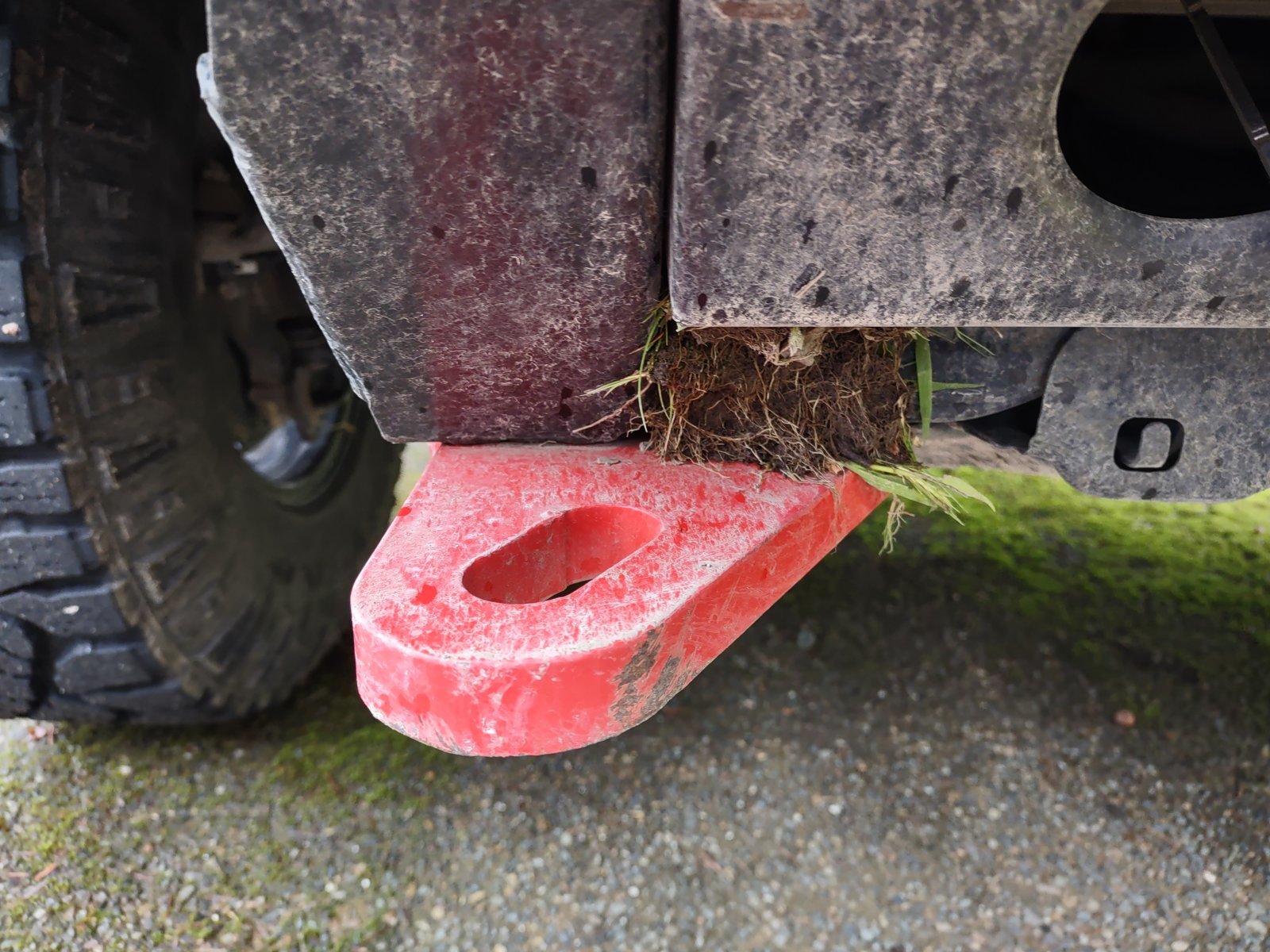

    I think I paid $50 or $75 for mine. Found it under a table, new open-box, at an offroad shop's "garage sale". Was a make-an-offer sale. I'm very glad i noticed the box.

    I'd treat it like my ARB, and NOT use a soft shackle. I'd use a D-ring Shackle to keep those from cutting the soft shackles.

    It was actually more about whether the OP already paid 300 or 600 in recovery boards, but didn't want to spend 300 on a rated recovery point. I see that kinda thing often. Or the giant light bars, etc, lol.
    but yeah, I have used my ARB recovery point like 2x. My Maxtrax, I've used them 50+ times, easy. Sometimes 5 or more times in a single day. my winch? I've used once, to pull out a rhododendron of my yard. But with my crazy heavy camper, I'm glad that ARB recovery point is there, especially if a wrecker ever needs to pull me outta a ditch or something.

    You aren't wrong... There was a lot more jammed in there before I made the drive home in the rain this weekend. I definitely felt it hit.
