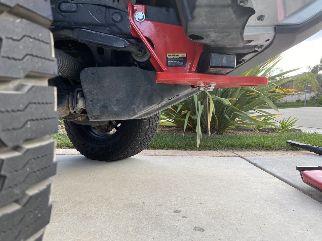

    I am reminded of a story involving a colleague of mine, another structural engineer, where he is standing in front of a large room of wealthier people. The types of people who pay for large construction efforts, or own enough land and have the resources available to finance large construction.
    He starts off by asking them a seemingly simple question: "What is my number one priority when it comes to the structures that I design for you?"
    The answers varied wildly: "To be as cost effective as possible." "To get me exactly what I want." "To create something that will last for 100 years." etc.
    None were correct.
    His number one priority, as is mine, is the protection of human life. That is it.
    He went on to say other things, but the point had been made.
    I will continue to inject myself into these threads, to continue to share my professional opinion about these garbage products (Demon Hooks).
    I can hope that people reading this in the future don't fall for the completely unverified 'it's strong enough' argument. Sure, in a purely static situation, connect a strap to them and give them a gentle tug. But extractions aren't always so straightforward.
    And please, to anyone reading this, do not believe what is quoted above.
    The demon hook is in no way, shape, or form a suitable replacement for the OEM hook. They aren't in the same league whatsoever.

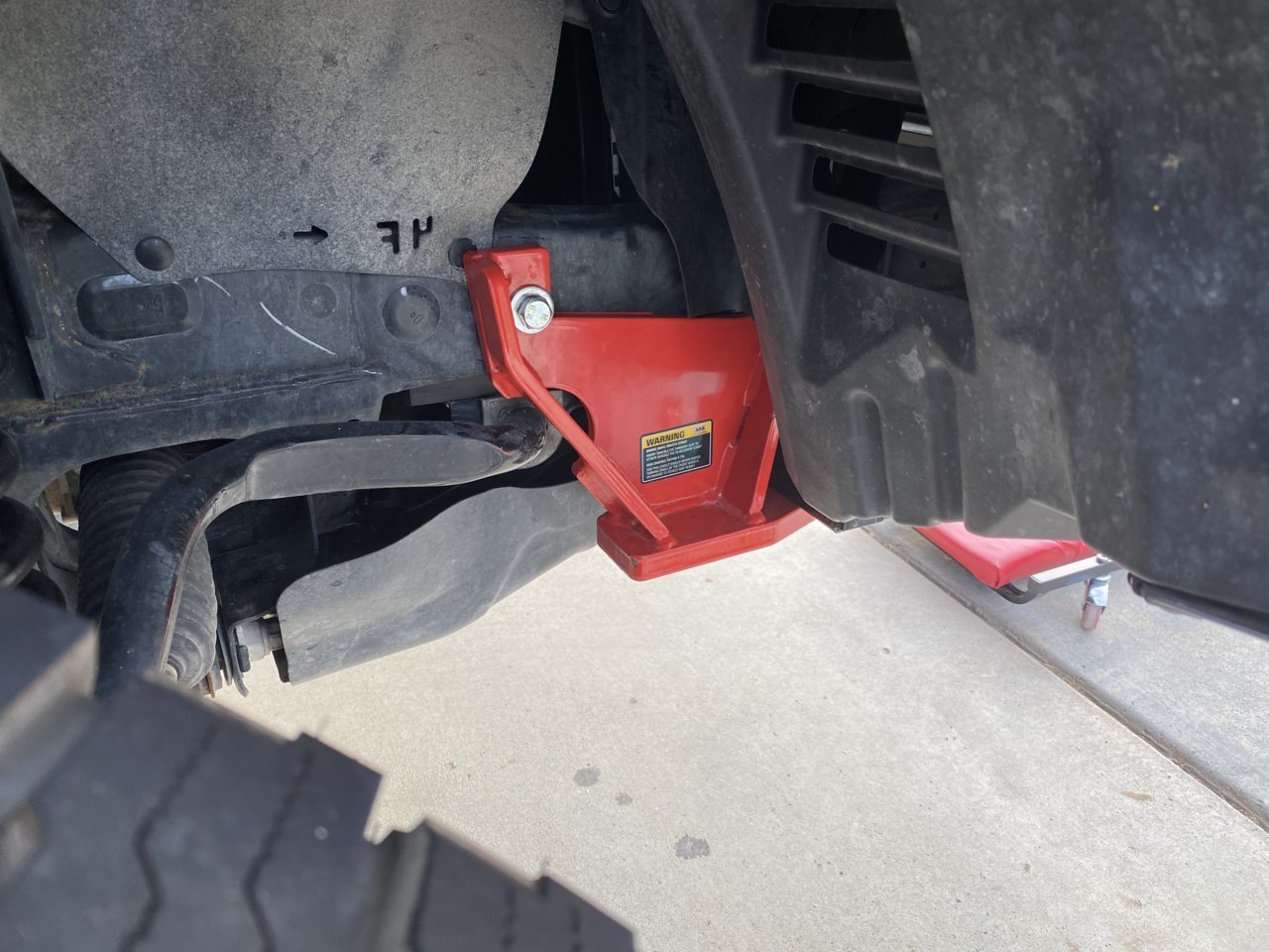

    not a recovery point - just a mount to hold a shackle (what they call it in the listing)

    no they are not as strong

    I actually had the bullet fabrication ones . They are nice, but the way that the hole is set up, you’d need spacers for the shackle when using. I ended up just selling them and switching to the Arb. It’s designed with actual load ratings and safety. PLUS the shackle goes through so it pivots correctly when you need to use it. It sucks they are so spendy…. But it’s worth it
