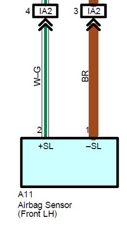

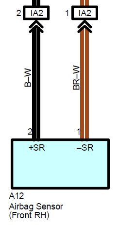

    I got what looks like a RH connector on eBay one purple wire and one green and white but the wires from the truck look black/white Stripe and brown/white stripe. Any advice would be MUCH appreciated.

    Thank you very much! Now do you have the same for the LH? I am pretty sure the harness I received is from the LH sensor.
