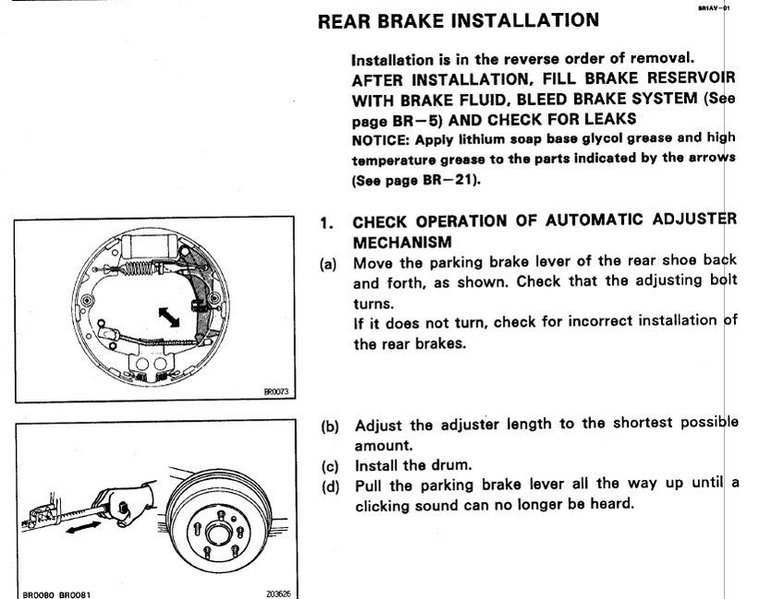

    The rear shoes on a tacoma are adjusted when you use the parking brake, not backing up and braking.
    You're thinking of Bendix/Wagner system using in American vehicles in which the brake shoes share a single pivot just above the hydraulic wheel cylinder. The adjuster links the other end of the two brake shoes. With that the shoes are effectively anchored at only a single point. The hydraulic cylinder can change the effective diameter of the shoes, but it can't keep it centered in the drum. When you apply the brakes, the lead shoe is dragged along the drum which pushes the trailing shoe against the drum and shifts teh adjuster towards the trailing shoe. When you back up, the leading and trailing shoes are reversed and the shoes will shift the other way when the brakes are applied.
    Toyota used a dual servo setup in which there are no leading or trailing shoe. Each shoe has its own pivot opposite from the wheel cylinder. No matter which direction you stop from the shoes do not shift position. There is no motion inside the braking assembly to operate an adjuster. And as such, the adjuster in a dual servo system is linked to the parking brake. When you pull the parking brake a mechanical lever (automatic adjusting lever) wedges the two shoes apart like the wheel cylinder would. If the brakes are out of adjustment there will be significant movement in this linkage before the shoes reach the drum. This is what moves the adjuster wheel. If the brakes do not need adjusting there is not enough movement in the linkage to turn the adjuster wheel.
    You can drive cross country backwards, but with a dual servo system nothing will change. The only mechanism which moves the automatic adjusting lever is manipulating parking brake over and over.
    Bendix/Wagner:
    Dual Servo:
    From FSM:
