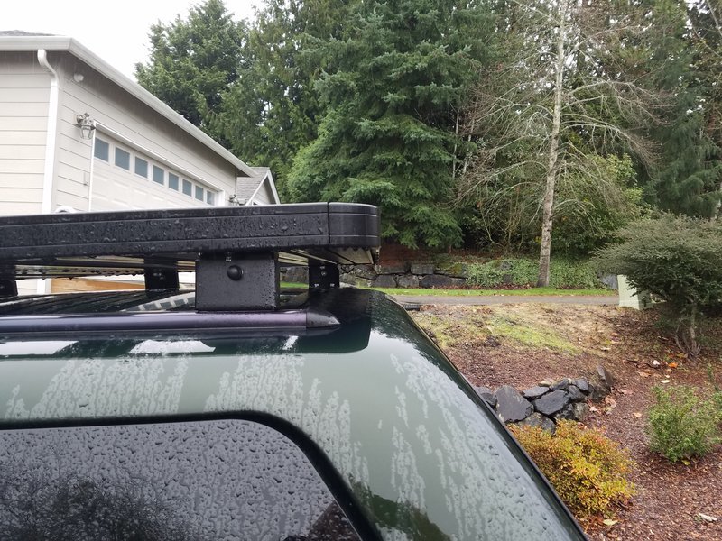

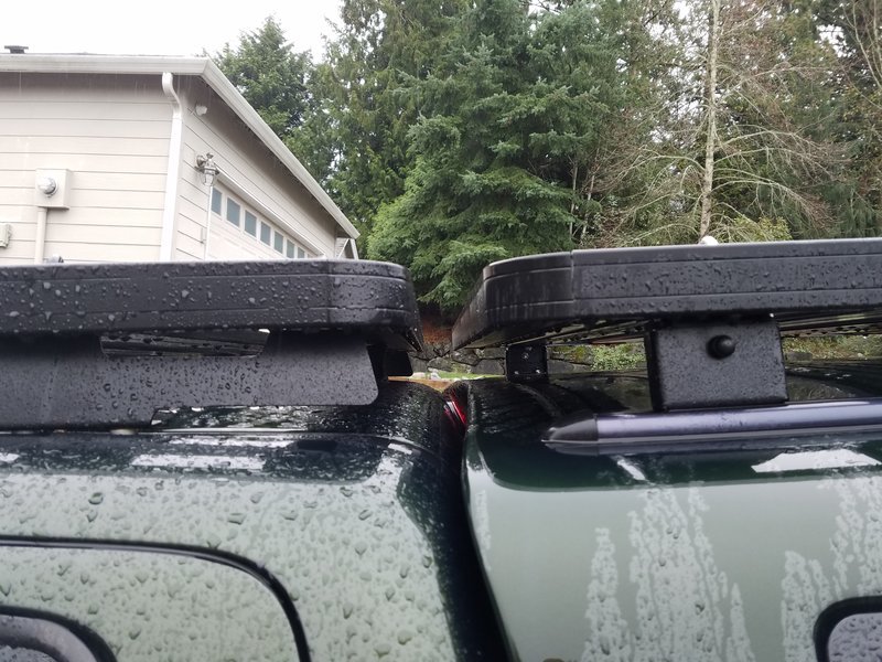

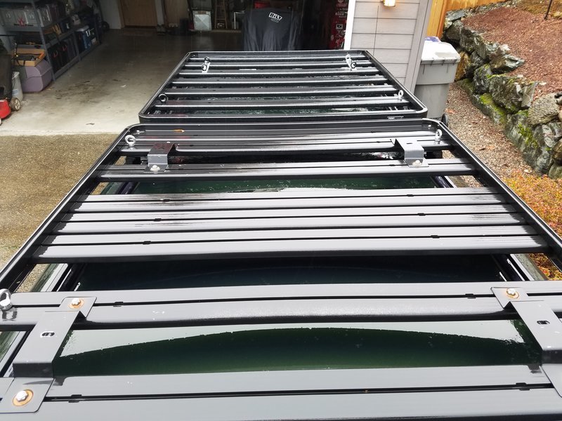

    The racks themselves have quite a bit of adjustability. I have both the canopy and cab racks. The canopy rack was first and I just eyeballed to get it centered. When the cab rack went on, I had to readjust the canopy rack to match. Not difficult, just takes some time for those of us with ocd. Also, you'll need taller feet for the canopy rack to match the height of the cab rack. I can pot some pics if you want.

    I had to adjust front/back and left/right to get it all square. I maybe have a half inch btwn the racks, and the canopy rack terminates just inside of where the canopy starts to curve downward into the glass.
    In fact, now that I think about it, I had to cut the side tracks a few inches to make it so it wouldn't overhang the rear of the canopy. I think some pics are in order. I'll snap some when it once again becomes light outside. And throw up some measurements.

    Canopy rack is 53.5" long from the outside edges.
