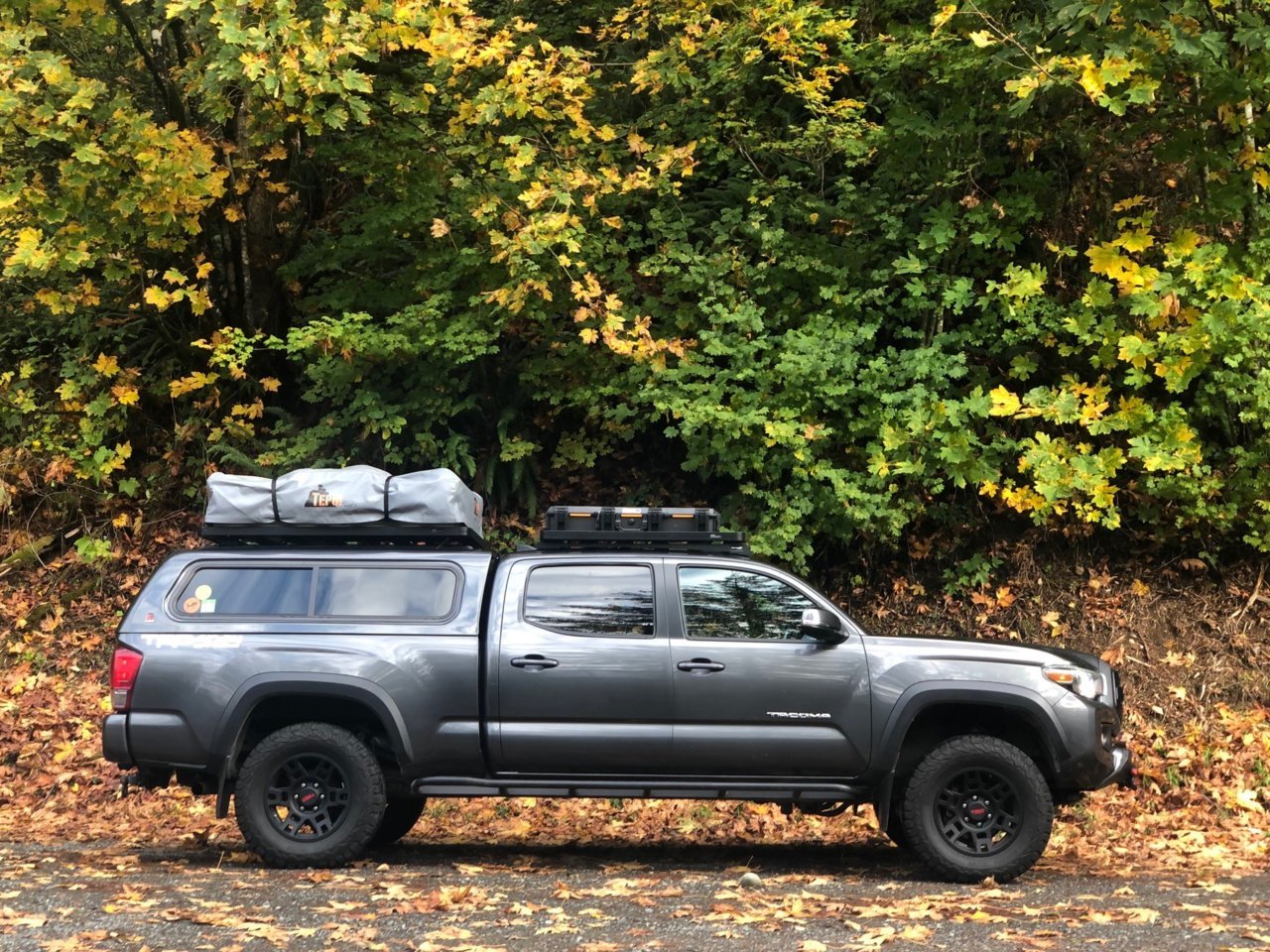

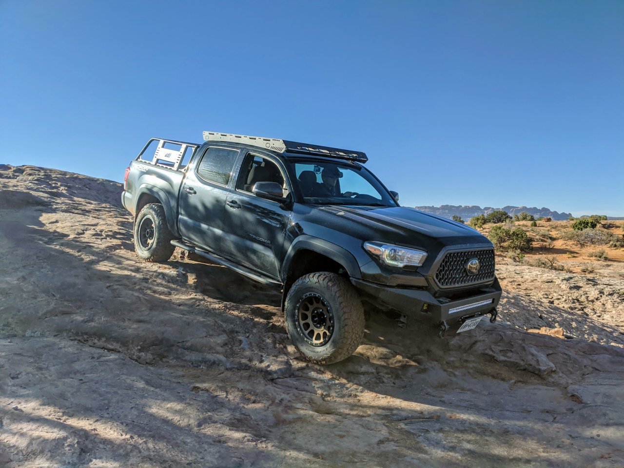

    They make two different versions of the Slimline rack for the Cab of the Tacoma. I have the low profile Slimline II rack on my cab. The regular one sits a little higher and is a little longer covering the Shark fin I believe. By its self I'm happy to report that with the small wind fairing that comes with the rack there is no discernable wind noise. Although depending on what you attach to the rack, boxes, gear, etc. your accessories can create a lot noise.
    A couple more pics of the racks in my build thread.

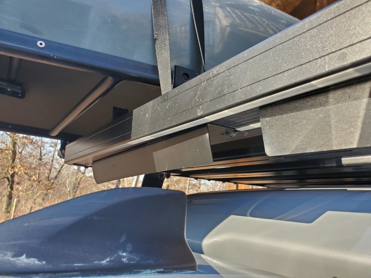

    Sure. But I'm pretty sensitive ("anal") when it comes to noises while I'm driving. I say its pretty quite with the included fairing. Did you experiment with the spacing between the 2 sides? Sounds like you are getting a funny harmonic or something. You can also try some 80/20 infill strips from Amazon...

    For me it just sounds like the air is bouncing up and down against the inside slats and the roof. Kind of like what your ears sound like on a really windy day in an open area.

    I had a little bit of that, then I played with the distance between the two fairings and it went away.

    Ahhhhhh, my fairings are literally touching at the point in the middle. I will go home tonight and adjust them and try again in the morning. Still can't wait to upgrade to a larger fairing though. Thanks for including that image.
