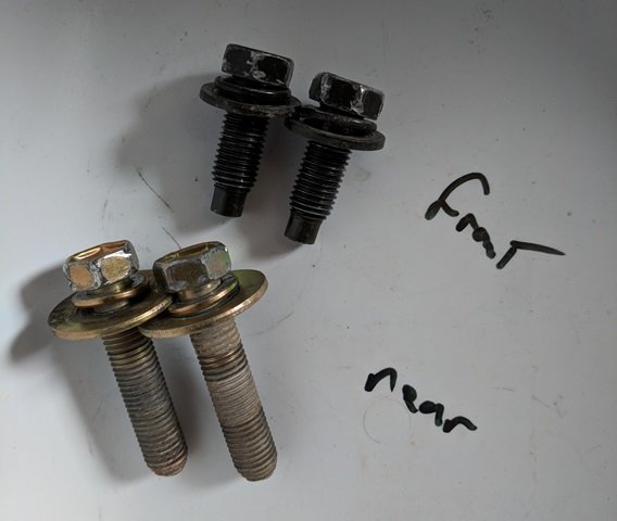

    @SilverhawkDad (OP) Perhaps this will help, as I also have a 2000 PreRunner V6 ExtraCab with Bucket seats. While working on my seats last year I took this photo to remind where to return the bolts. This was the front passenger seat.
    Let Me know if that helps
    GQ7227 and ace_10 like this.
