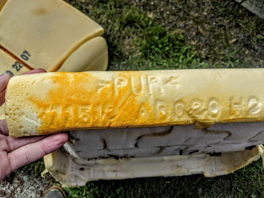

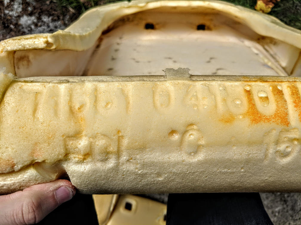

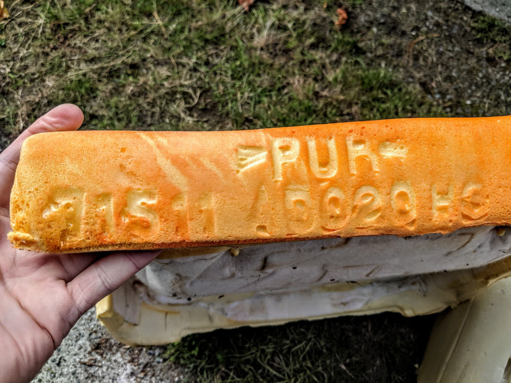

    I have a 2010 Toyota Tacoma double cab that I'm re-upholstering with Katzkin leather (thanks @jhuey8947). It's going well, except that this truck belonged to a smoker and the front seat foam smells so terribly bad of smoke that I think replacing the foam is the best option.
    From what I can read off the seats (I'll attach photos), the part numbers are:
    Front Left Back: 7155204060 (looks like it says "H2" after)
    Front Right Back: 7155104180
    Front Right Bottom: 71511AD020 (looks like it says "H5" or "HS" after)
    Front Left Bottom: 71512AD020 (also has H2 after the number)
    I think these are the correct replacement parts (at least the website says they fit):
    https://parts.toyota.com/p/Toyota_2...-Cushion-Left--Front/63316006/7155204060.html
    https://parts.toyota.com/p/Toyota_2...GHTFOR-SEPARATE-TYPE/63477315/7155104180.html
    https://parts.toyota.com/p/Toyota_2...n--For-SEPARATE-Type/63328323/71511AD020.html
    https://parts.toyota.com/p/Toyota_2...n--For-SEPARATE-Type/63120566/71512AD020.html
    I'm confused about why some of these say "For separate type", or the significance of the "H2" after some of the parts. Toyota has a hefty 35% restock fee if I get this wrong (and the foam isn't cheap), plus whatever return shipping would be, so I'd like to get this right. Any confirmation would be helpful (or any other thoughts on how I could go about this!)
