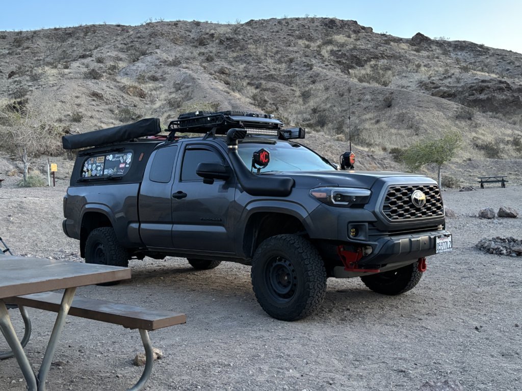

    A lot of people will say that most shackles aren’t rated to pull/recover. There’s a few options like the arb one that bolts to the frame. I do have a cheap Amazon bracket with a moose knuckle shackle that is more of a tie down point.IMG_0485.jpg
