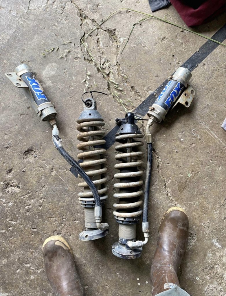

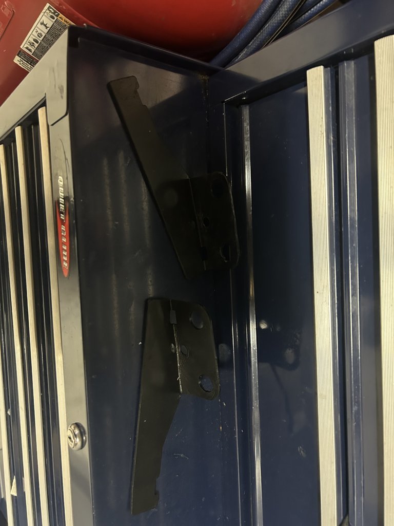

    Good evening Everyone, I recently picked up these shocks from face book market place. With buying them they came with these shocks mounts. I took them off the shock to paint them black and also sent the shock to be rebuilt. while waiting I wondered ima put them on but when looking i cant find where these bolt up if even the do.:confused: I also cant find anything on here. I know its possible but i don't know how.:help: If ya'll possibly teach the way that would much appreciated.

    They usually bolt in between the stabilizer bar brackets and frame.
