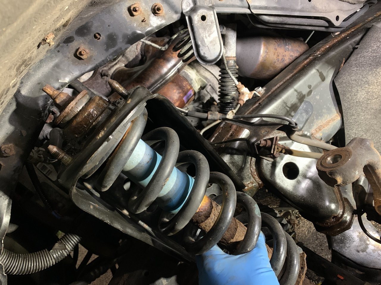

  12. Sep 2, 2023 at 4:29 AM
    #32
    otherphone
    otherphone Well-Known Member
    Aug 18, 2023
    #431549
    121
    MA
    09 tacoma sport
    OME2.5lift w/medium leafs
    Did you get new uca’s yet? I just put in the old man emu ones and they look mint. Got them from polyperformance w code poly10 for around $500. My driver side front coil over is so stuck it feels like a extra bolt or something must be holding it in idk, usually when I take off the top 3 nuts the shocks just fall strait down. I let it soak in penetrating oil all night and I’ll try again in a minute
