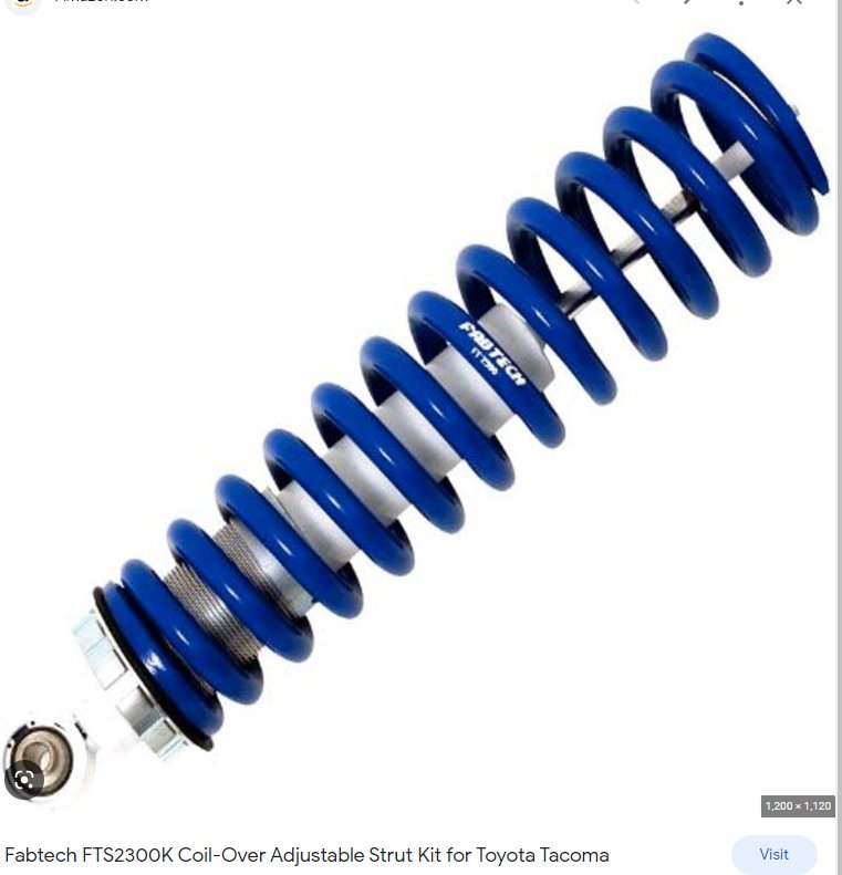

    I have a 01 Tacoma, 4x4 V6. When I bought it it already had a lift kit but dont really know what size. went to get it lined up and was told the front shocks are bad. It has a FabTech FT2300 coil over on it but the shock is rusty. Can anybody tell me what shock I need to go back with.

    I had a set of those for my first lift (20 years ago). 0-3" of lift depending on how far you adjust the collar.
    The ride was garbage, and I ditched them for Kings after a year.
    Just replace them with the Bilsten 5100s and OME coils. You'll be way happier.
