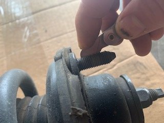

    Does anyone know the size of the threaded studs on top of the shock mount, the threads on one of the studs are boogered-up and I need to get a die to attempt to clean them up. I know the nut part number that fits on the studs (Strut Mount Nut 9008017215), but unfortunately the part description doesn’t say the size of the nut opening/thread.
    Worst comes to worse I’ll take a trip down to Home Depot and use their nut sizer, but trying to avoid that as HD has been a mad house during the pandemic.690EEE3C-4E94-41A7-8E1E-B88BDCFD786C.jpg

    I swapped mine a few months ago. I can see that the TPI is 20. I only have a partial SAE tap/die set. I assume this is metric and from a few quick measurements I'd guess the thread is 10 or 11mm and definitely 20 TPI. You could at least give that a shot and/or get a few in that range and one will hit the mark.

    Thanks for the replies it turned out to be M10-1.25, ordered the die, hopefully it does the trick, so I don’t have to buy a new shock mount.
