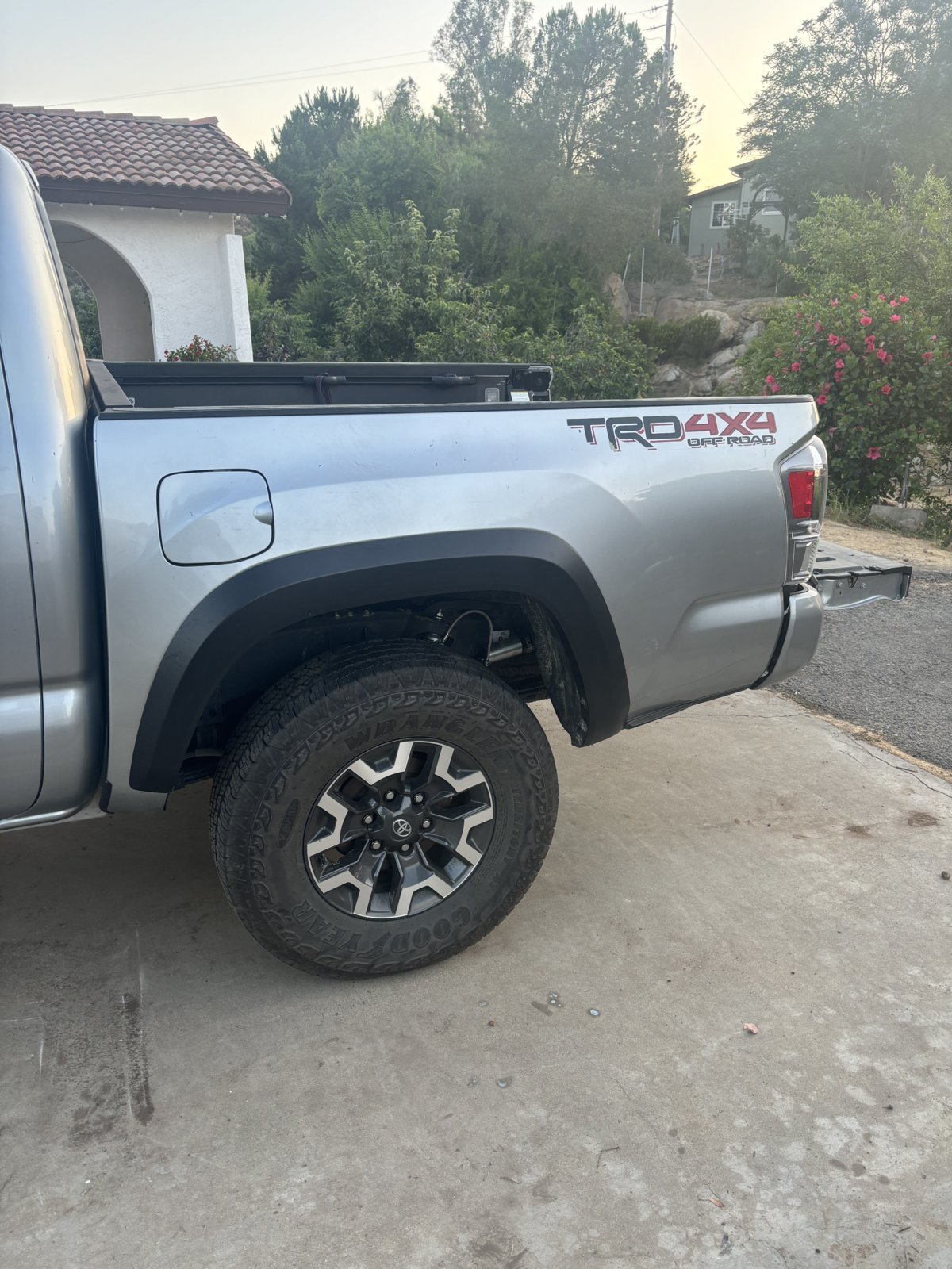

    i installed bilstein 5160 rears on my 3rd gen and went to order the front 6112 and there on major back order? anyone have any other brands that i should pair with the bilstein rears,
    mostly fire roads but occasionally desert off-roading. or point me to a thread with similar situations! thanks
