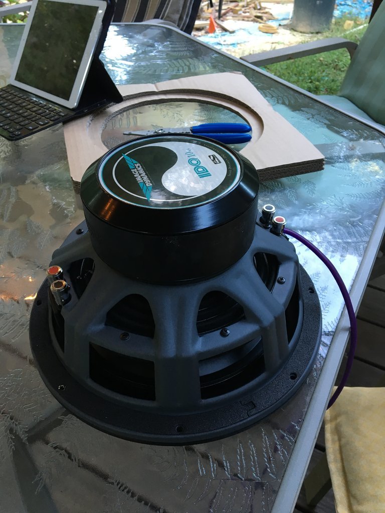

    TRD Pro Grille Predator Step Tube 17" Maverick Alloy Wheels Nitto A/T Terra Grappler (265/65R17) Tri-Fold Hard Tonneau Cover with LED Lights V6 Tow Package Chrome Exhaust Tip XP Badging Stereo Pioneer AVH-X5800BHS Arc Audio 900.6 - 6 channel amplifier (4x60 watts + 1x550 watts bridged) Arc Audio 300.2 - 2 channel amplifier (2x180 watts) Hybrid Audio Technologies Clarus 1" tweeter Hybrid Audio Technologies Legatia 3.5" mids Hybrid Audio Technologies Legatia 6.5" midbass Image Dynamics IDQ10v4D2 10" DVC sub Stinger Roadkill Sound Deadner 200 AMP Circuit Breaker: Rockford 200 Amp Circuit Breaker Krystal Kable RCA Cable KnuKoncepts wiring and interconnects
    Image Dynamics IDQ-10 fits in a sealed 1 cu ft box perfectly in a 2017.
    destin_meeks[QUOTED] likes this.
    Dimensions for my box made out of 1/2" birch plywood. stuffed it with polyfiber too.
    RJ_MacReady and destin_meeks like this.
