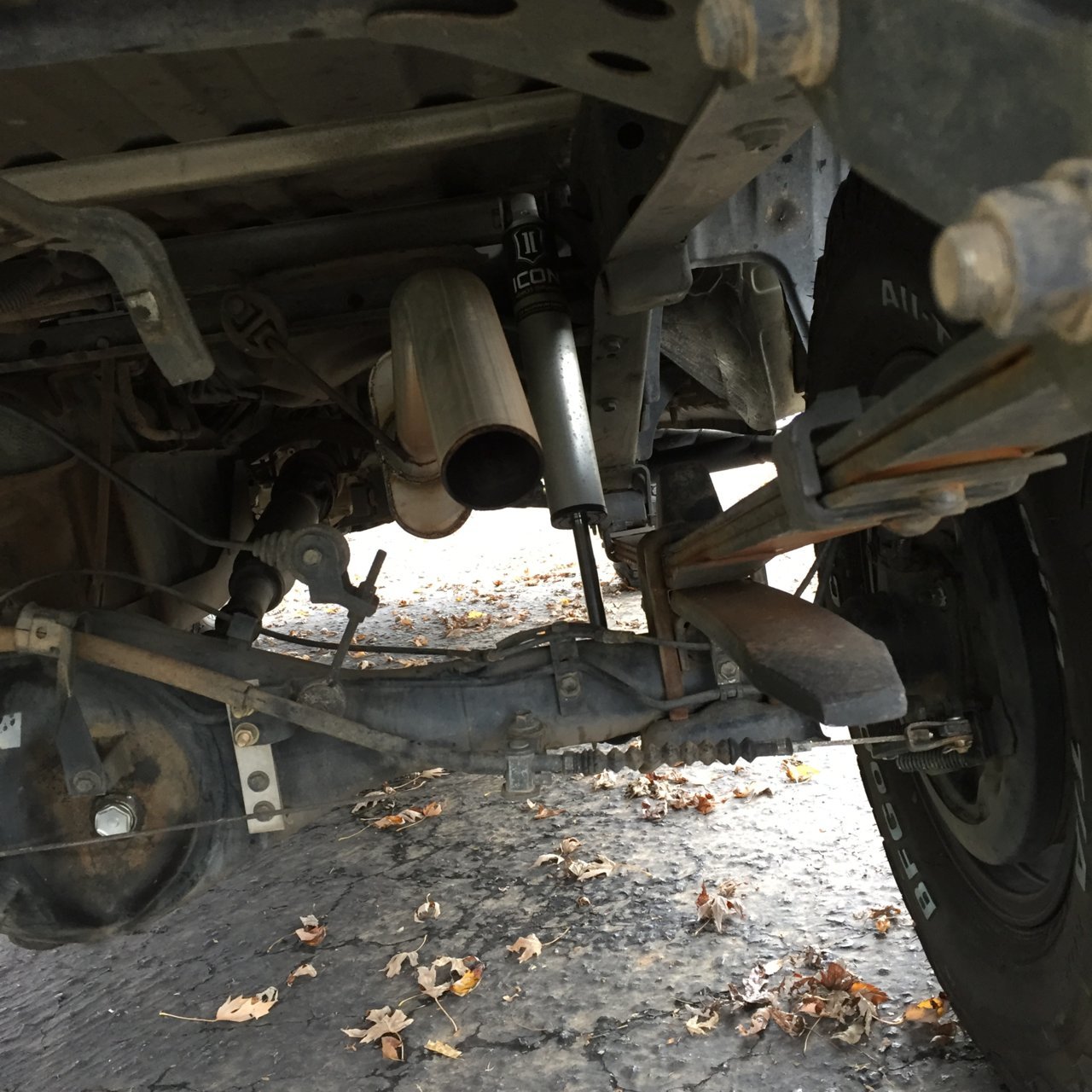

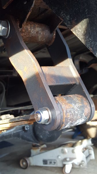

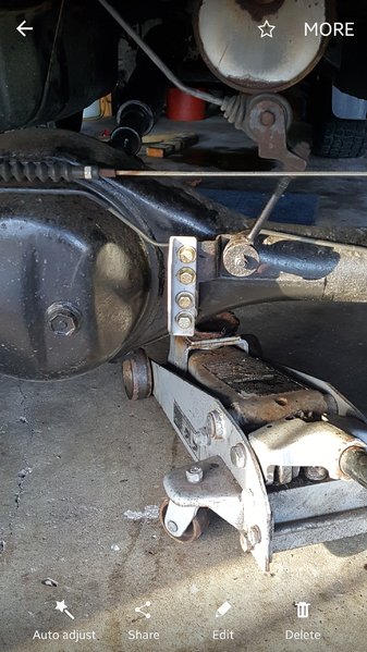

    Hello all,
    With those shackels on the rear, does the ehxaust hit on the passenger side ? Mine rubs the chrome T.P.
    I have an 02 Prerunner 2 w/d and am thinking of going back to the origianls, (shackles), and just replace the front spacers to level out the truck.
    Riding 265/75/16 on stock rims.

    ... what?
    You currently have some sort of spacer lift (front) + shackle lift (rear), and it's causing the exhaust pipe to hit the passenger leaf spring. right?
    We cannot possibly tell you what spacer you need- that's insane.
    And your current solution is to remove the shackle to reduce the rear lift, and try to match the front?
    What are your priorities?
    Do you need the lift for off roading?
    I'm guessing not if you're willing to ditch the lift.
    Is the exhaust tip more important to you than the lift?
    Personally, I'd just cut the exhaust tip off so it doesn't hit the leaf spring. I did that 22 years ago and haven't looked back since.

  11. May 28, 2023 at 9:26 AM
    Red_03Taco
    Red_03Taco Well-Known Member
    Nov 2, 2021
    #381170
    1,729
    Jerad
    2003 Tacoma Xtra Cab 4WD
    That last picture really makes it look like your leafs are way flattened out, AKA you need some fresh leaf springs.

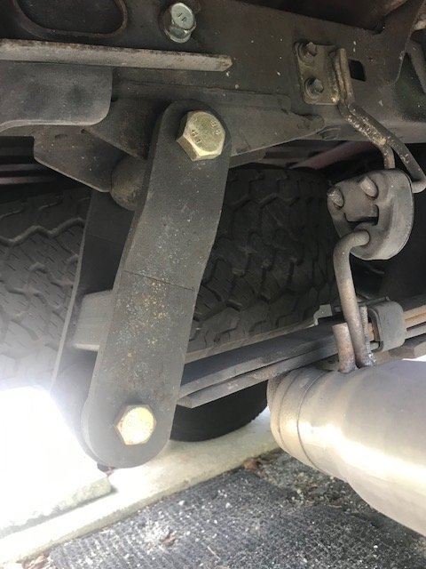

    I had the same issue. PO had installed 2" shackles and must have rerouted the tailpipe. When the time came to install the Walker cat-back system, it would not fit due to leaf spring interference with the tailpipe.
    My solution was to install ProComp 2" add-a-leaf. My shackles have 2 different mounting heights. Re installed the to the OEM position. No more clearence issues.
