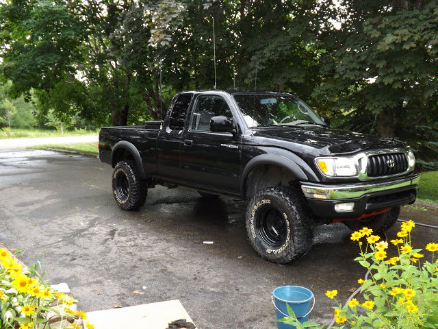

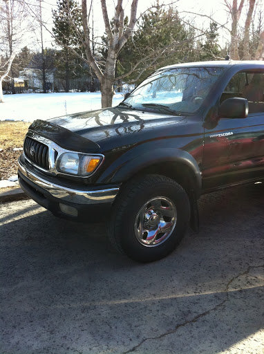

    i had spacers that go on top of the top plate they were 2.5in i believe and the ride was close to stock! i wouldnt put spacers if you do some serious offroading. i can post pictures of it if you want,

    jamtoz
    jamtoz frog
    Mar 25, 2012
    #75620
    1,487
    James
    Quebec
    trd sport DCLB 4x4 2014
    Duratracs, SCS sr8's, debadged
    before
    after
