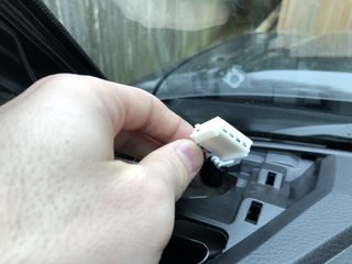

    I recall from the Crutchfield instructions...They made a note that the four front speakers need to be all plugged in.

    You are correct, the teeeter connector is 4 Separate pins for some reason I was thinking they were doubled up in parallel. So without the tweeter plugged in it will not complete circuit and jump audio down to the front speakers here is a picture
