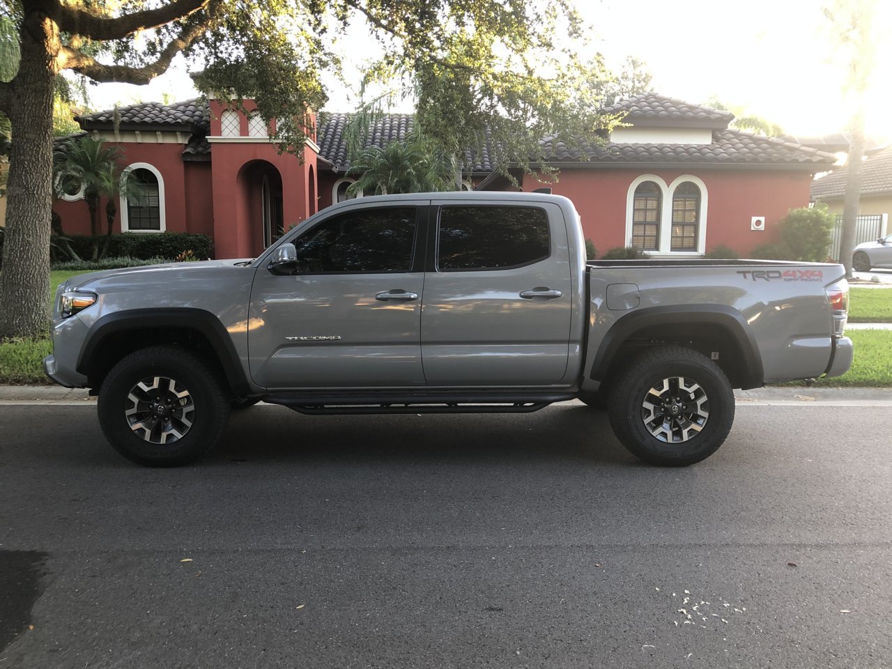

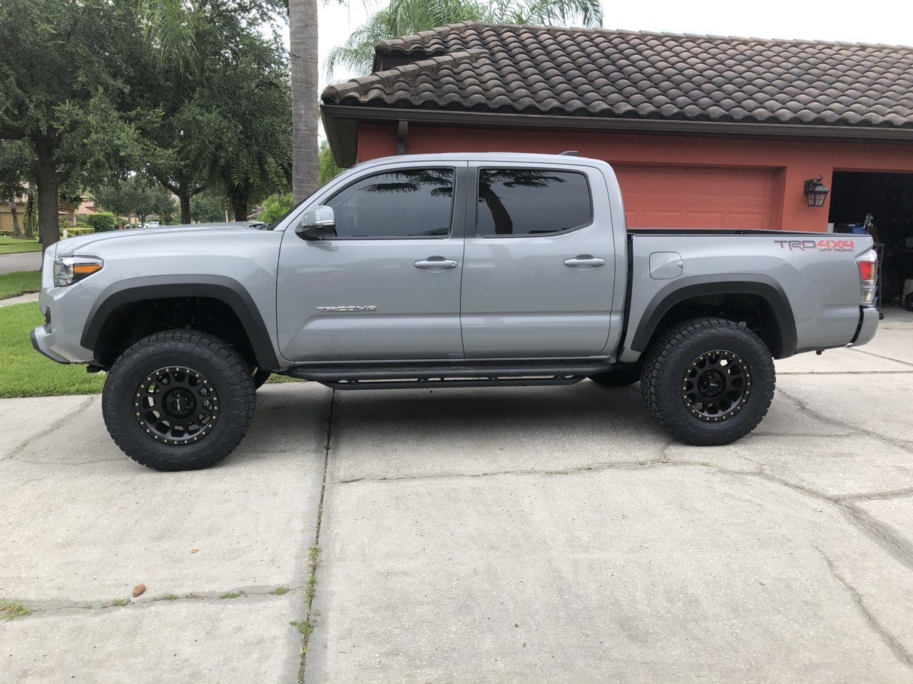

    First post. Quick question. I just had a lift installed on my new 2020. Bilstein 5100's all the way around with the OME 888 front springs and an Icon Progressive AAL. After installation I got a full 3 inches on the front and only 1" in the rear with the AAL. I was hoping for the expected 2.5" front and 1.5' rear to level it out. Needless to say the front is a little higher than I'd like. How much if any front sag can I expect from the new springs? At this point I'm debating about going to 887 fronts, or maybe just replacing the AAL with a Dakar rear leaf packs. Thanks for any input!

    With no extra weight up front and just regular driving, you wont get much settling... If anything, the rear will settle more than the front ever will. If you have future front mods planned (bumpers, batteries, winch... I dont know your plan) you'll be okay then... but then with 888's youll eventually get to the point where youre too heavy in the front... Hahahaha you see where this is going? Youre never done... Welcome to TW, bud :thumbsup:

    Ome springs will defintely settle

    Then you have 2 options 1 get a softer spring 2 add more front end weight like a bumper

    9
