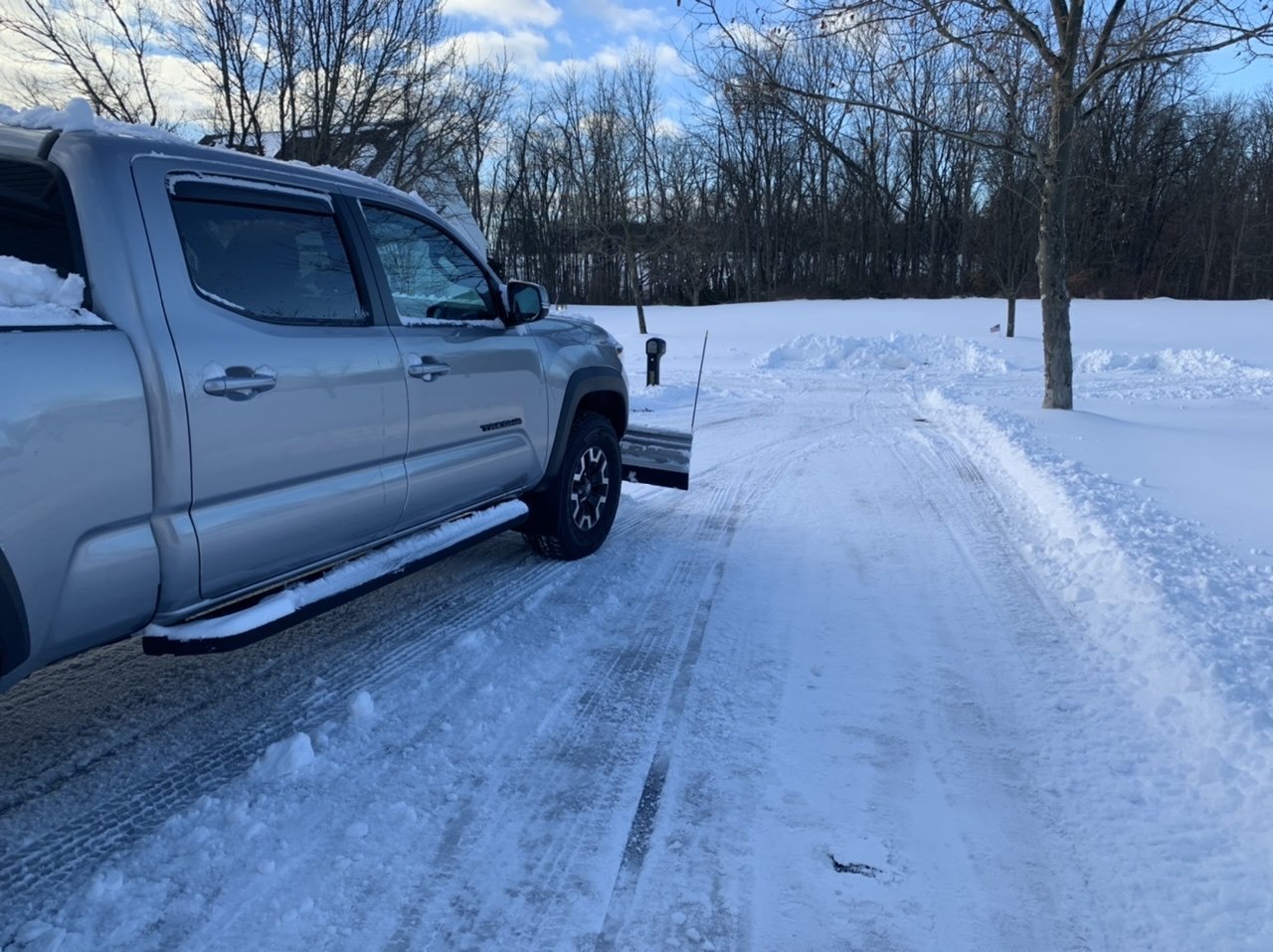

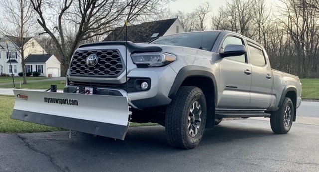

    Here it is on the front. :)
    ndoldman59[QUOTED] and jwctaco like this.

    So how do you like it? It seems like it would have limited use for deep snow depth for the low profile blade.
  17. Dec 28, 2021 at 4:39 AM
    #17
    Doc62
    Doc62 Well-Known Member
    Nov 7, 2020
    #346138
    641
    Dave
    SE Pennsylvania
    2025 Tacoma TRD Off Road i-FORCE Max, 2019 Sahara
    The most I have had to deal with is about a foot with no issues. The blockage at the street from the township snowplow was a couple feet, but it pushed through it nicely.
    ndoldman59[QUOTED] likes this.
