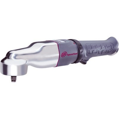

    I just use a snap on socket, some of the cheaper ones fit a little loose. But problem bolts get the good stuff. You can unclip and move wires if you want to torch them.
    Also the hammerhead impact is a lifesaver! It fits anywhere!
