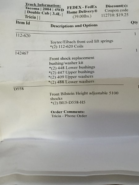

    I bought a bushing / washer kit from ToyTec.com for $20.99 when I bought my front adjustable 5100's.
