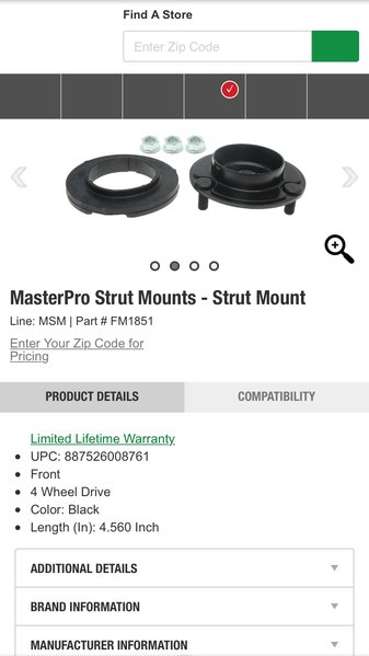

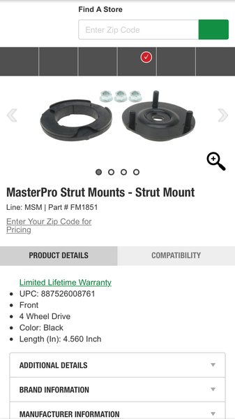

    Here are the ones I bought from O'reilly's when I put my 2nd to last lift on and they are still in perfect condition 3 years later. Good price. Not OEM but work just fine.
