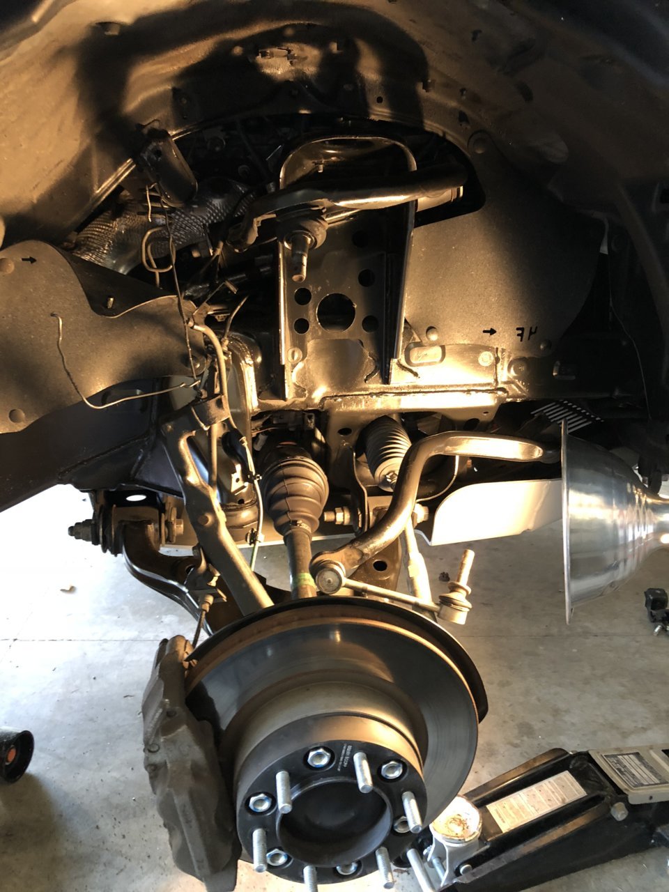

    Yeah it’s pretty easy maybe 40 minutes work a side...you don’t even have to remove the brakes or touch the lower control arm bolts or ball joint just push it out of the way strut comes right out...add your spacer and put it right back in.

    To answer your question I lamas looking on another thread and it says his has been just fine. I didn’t change mind. My truck was just in at Toyota get scheduled service and I had them look over and all was fine!

    Is that true? I am adding a 1/4” spacer to top of strut, you do not have to remove the brakes and all the other stuff to get the assy out?
