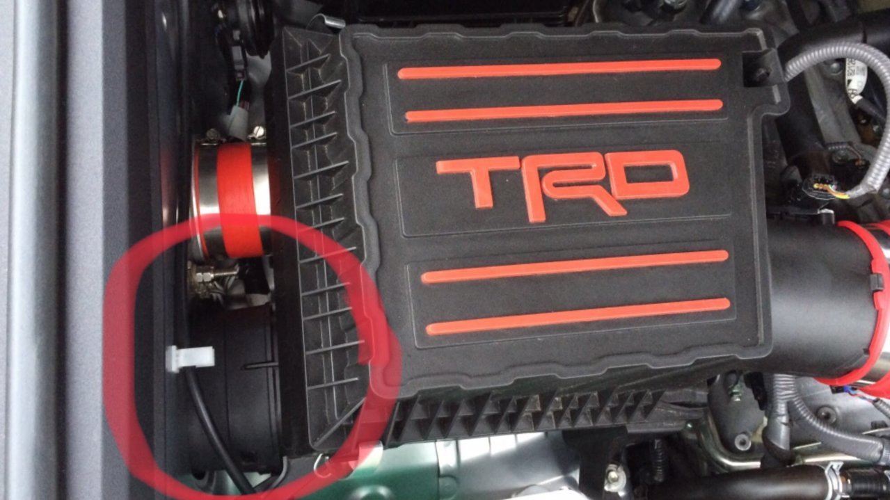

    can you take a photo of the location of the crack a little further away so I can better understand it's location? I'm brain dead right now and am a bit interested in how this could have happened.

    If drivers side, its the battery weight, seen it on a few 2nd gems. Mostly guys that haul ass on dirt roads. The inner fender cant support the weight of the battery. Crappy design.

    Not my pic but if you removed the air box it would be in the circled area. D788187D-2380-4B83-9108-2985DF9B3DE7.jpg

    Soooo....that crack and your broken fan shroud are both on the same side/general area yea?
