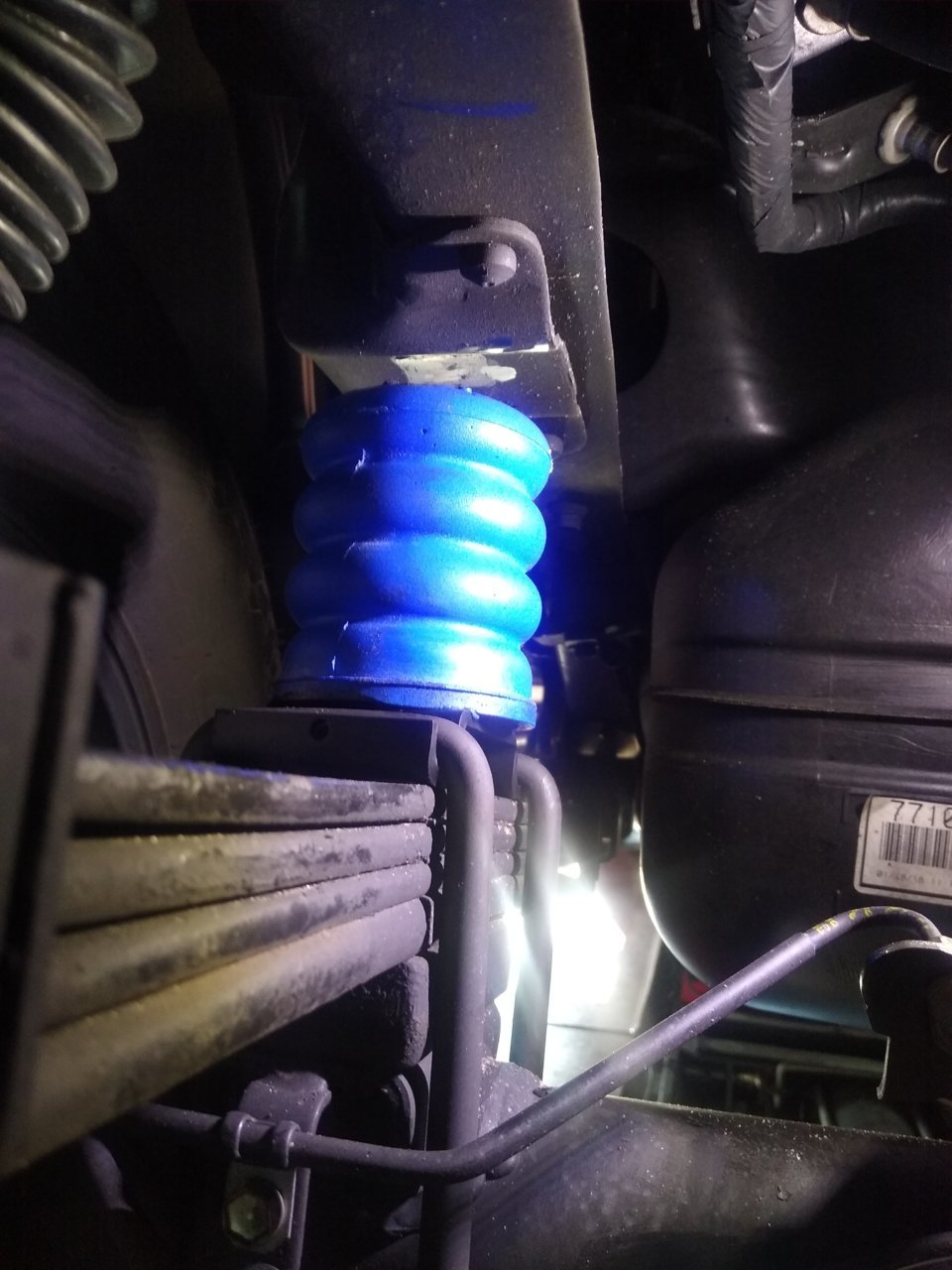

    Bilsteins 5100s on the top setting, 4runner Gray TRD Pro Sema wheels, 285/70/17 Toyo AT3s, Sumo Bump stops, TRD exhaust, ECGS Clamshell bushing, 1/4 shim for the lean and one inch rear block, OEM Pro grill and garnish OEM TRD Skid plate, TRD CAI, Demon Brackets, Rigid Industries Pro fog lights, OEM Trail Rails sidebars, Diode Dynamics LED SL1 high and low beam lights, OEM Roof racks, Clazzio leather heated seats, Remote Start, TRD Pro shift knob, tinted windows, Rockford Fosgate 4 channel amp for the headunit and sub and amp combo, OEM Puddle lights, OEM tailgate lock, OEM bed mat, LED interior lights, OEM blackout kit for letters, JLT catch can, upgraded 27F toyota True Start battery, Vleds led tail light kit with Pro tail lights, OEM Rave4 side mirrors with convex spotters,just to name a few mods.
    I did some errands, in town and some highway driving and I will say its a major improvement on an already great ride. It soaks up so much of the little things. Getting ready to install the rears this evening. If your thinking of getting the fronts, just do it and I hope I have the same review of the rear stops.

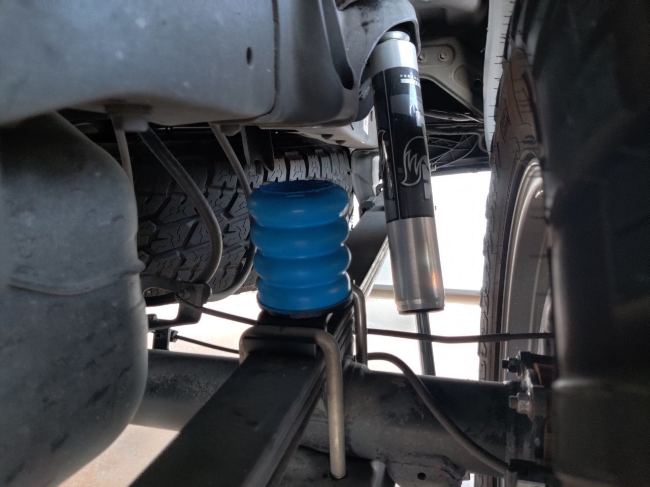

    The rears are installed, and I have 5100s and a 1in block, larger ubolts required a 21 mm socket and called for 100 lbs or torque. Installed them on a drive on ramp, took about 15 minutes, air tools and done. The stops have about a 1/4 to a 1/2 of space. Rides great, the new rear stops kind of completes the package. I guess it's fair to say that's it feels more balanced in a good way. Cracks in the roads and man hole covers can barely be felt, some improvements in handling and the ride are better which I never had an issue with. IMG_20210913_170951400.jpg

    The stock ones which of course are smaller would still hit as you can see in the picture I posted where the paint has worn off. So yes they work and even more so now. I have a small 1/4 gap now as opposed to before when there was even more space. To answer your question they do soak up bumps better unloaded however I rarely will put a load on the truck.

    The rears perform differently than the front as it seems the front is intended for stock height and contact (or minimal gap). Think full time pillow/cushion
    The rears not like that- gap unloaded (likely 1/2”-1”ish) and as you get a load the rear sags and when you sag enough to make contact THATS when these benefit. They will limit/reduce further sag and give you that boost. Think air bag without the hassle of airing up/blown lines etc. If you don’t have a gap unloaded then you’ll likely have a rough ride which is what happened at the beginning when ppl were installing the 2nd gen model, then they made a shorter version for 3rd gen. Remember this is stock, if you have a lot of weight already then you might not have a gap and they are doing what they are supposed too. If you are lifted you may want to ask about spacers to raise and lessen the gap caused by the lift or go with the 2nd gen. Best to contact them directly and give them your specs and recommendations.

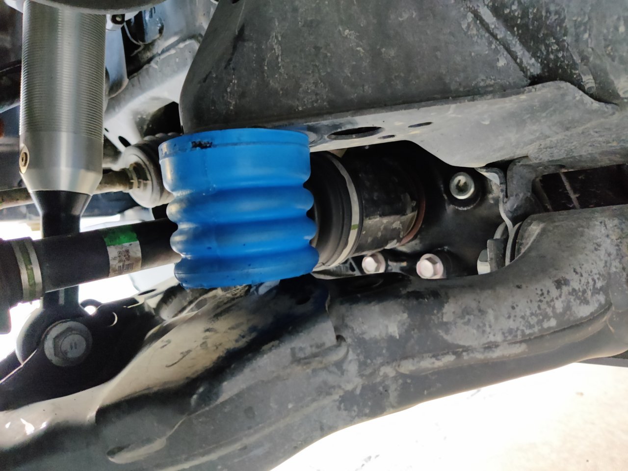

    Installed my fronts. I can def feel a difference. It softened up the ride a bit. Less body roll like previously reported. I'm glad I bought them.
    My Specs: 5100's with stock Springs and lifted 2 inches. 10 Ply Tires.
    I was able to install by just lifting the tire off of the ground. Channel Locks to take off the old Bump Stop, and a 17mm Wrench for the locking nut for the new one.

    Unless you mounted it differently than the stock bump, the nylock nut is not used (or washer) with our application. The welded nut on frame and thread locker is it
