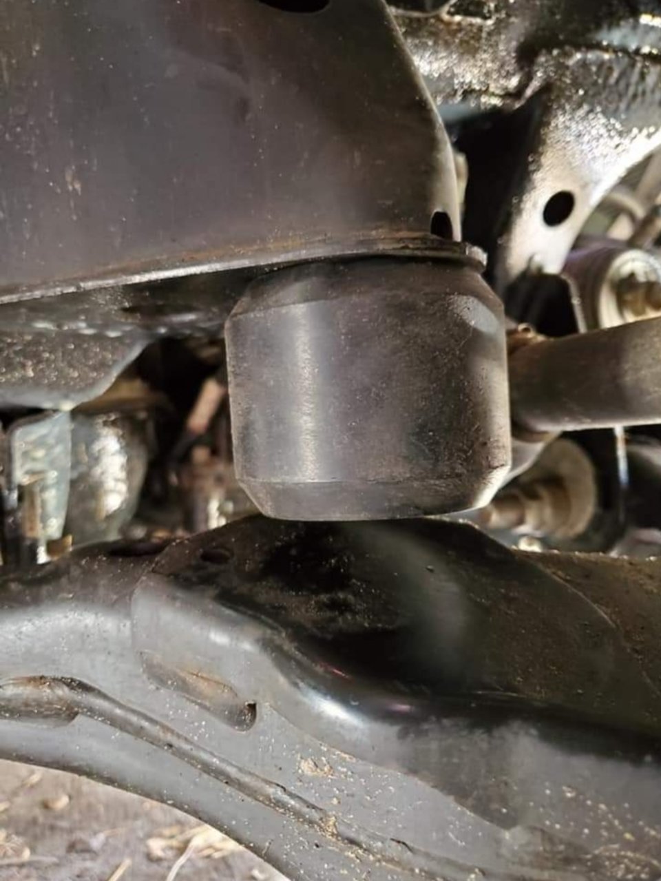

    Welp, I finally got the fronts installed and ironically it was super easy to remove the oem bump stops but I had to angle grind about a quarter inch of the bolt to get the sumos installed.
    I couldn’t get the thread started because it was so tight against the LCA, even with the wheel off the ground.
    Feels like the front sits about an inch taller and side body roll is practically gone. Definitely dampens the little jarring in the steering wheel.

    Future readers of these posts:
    You don’t need to cut the bolt to install them. Put a floor jack under the cross member in the front and raise the truck to relax the suspension, angle the bump stop with the bolt lined up, then tap it with the side of your fist so the SummoSpring compresses enough to line up under the threads, then hand spin it on. When it’s 90% threaded in, put a drop of the included thread lock on (so it is on the portion of the threads that will be in the welded nut).
    No need to grind the bolt down, or use the included nut. The nut is included for different applications that don’t thread into a welded nut, and there are instructions included that show this.
    If you I have a floor jack and channel lock pliers handy, the whole removal and install literally takes no longer than 15 minutes for both sides.

    Installed it today. Tested it on rutty fire roads . Stock 2017 off-road long bed. Initial impression are what others have said. Absorbs small road imperfections and doesn’t transmit to the steering wheel. Eliminated the lean on turns . Rides better . Doesn’t bottom out in dips. Most of all, feels planted on fire roads at speed. No bottoming out . Just for this , I highly recommend this for those with stock off-road suspension who want better off-road handling . This should come stock in all off-road models . Ooops almost forgot, almost fixed the taco lean. Thanks @TheRedComet for creating this thread.
