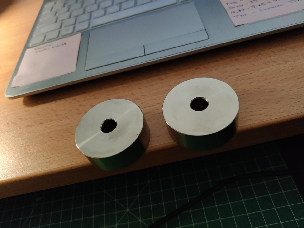

    i bought some spacer on ebay.. 3/4, 1'', for the front.. and 1 1/2 for the rear... ill see what happens but it should work for my 3'' lift

    Paid alittle more for stainless steel but think it should work... Waiting for rear spacers and I'll put it on the week end.. the rear I'm gonna have to cut the original thread and drill a hole for a longer bolt but think it should work .

    You didn’t see my post on stud length did you? You don’t have that much thread for all that- for whatever that thickness means 3/4 or 1”.
    You have 1/2” of remaining thread for full thread engagement in the front. As for the rears, you’ll have to cut off and drill out the stud in the bracket then use a countersunk head (name?) bolt. 1 1/2” seems excessive, should of contacted super springs for recommendations because they’d probably recommend the gen 2 sumos for your lift but that’s just a guess
