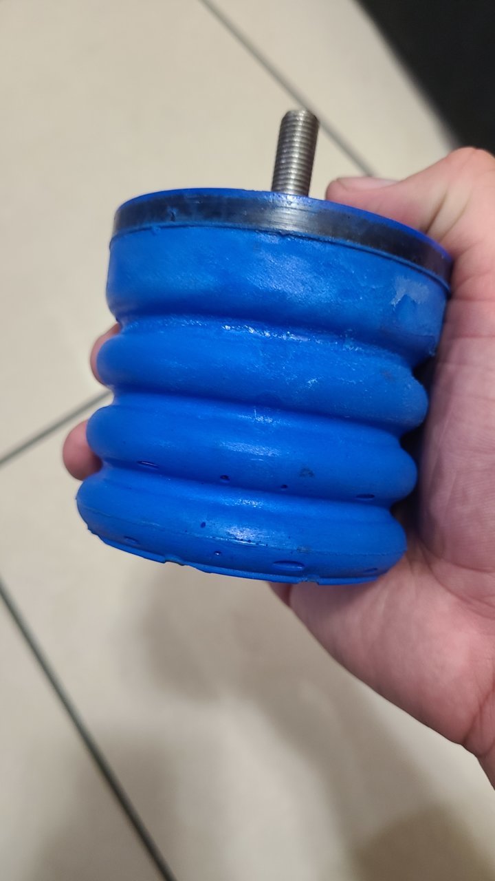

    Delivered yesterday and installed last night, took about 40 minutes. Like others have said, on my stock SR suspension you have to press them in and be careful to line up before screwing them in so to not cross thread. I have a tap and die set, been there done that over the years, so wasn't too concerned. Mine do make slight contact all the time which is ideal IMO.
    I didn't notice a big change in softening the ride, expectations were probably too high and my roads aren't bad. What I did notice was the improved handling with much less body roll on corners which I like very much, even takes a little getting used to.
