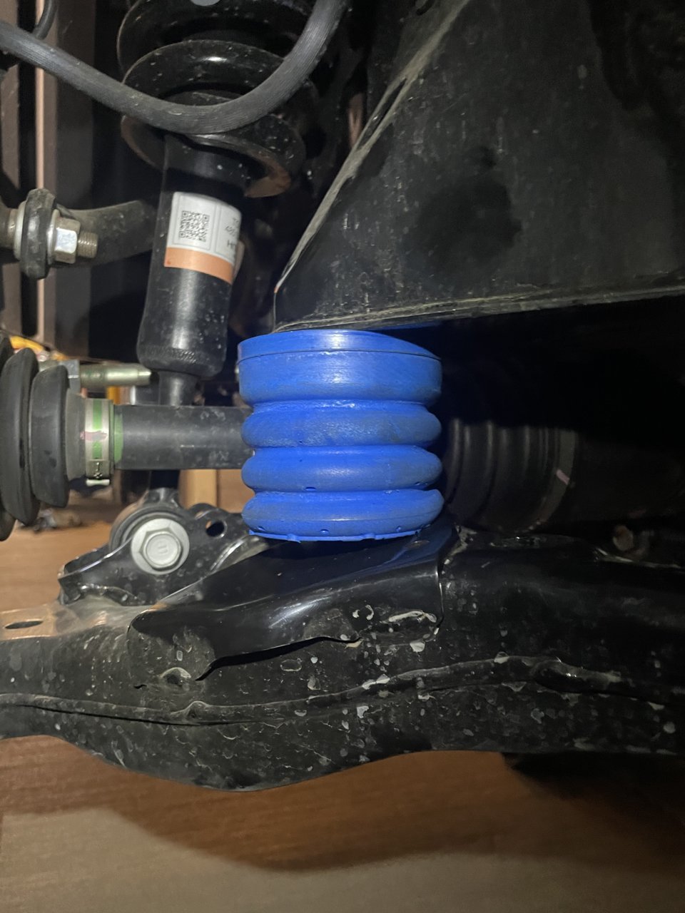

    Pro grille, Black SEMA wheels, air dam delete. Rear Blue Sumo springs. Front Timbren Active off road bump stops. Bilstein 5100s front and rear.
    Mine do and I'm leveled. Ideally you want them to touch.

    240
    I contacted them just because and they said that they are supposed to be engaged immediately. I thought this was odd since they will be constantly under pressure but if that’s what they were designed for then I can’t complain.

    Bilsteins 5100s on the top setting, 4runner Gray TRD Pro Sema wheels, 285/70/17 Toyo AT3s, Sumo Bump stops, TRD exhaust, ECGS Clamshell bushing, 1/4 shim for the lean and one inch rear block, OEM Pro grill and garnish OEM TRD Skid plate, TRD CAI, Demon Brackets, Rigid Industries Pro fog lights, OEM Trail Rails sidebars, Diode Dynamics LED SL1 high and low beam lights, OEM Roof racks, Clazzio leather heated seats, Remote Start, TRD Pro shift knob, tinted windows, Rockford Fosgate 4 channel amp for the headunit and sub and amp combo, OEM Puddle lights, OEM tailgate lock, OEM bed mat, LED interior lights, OEM blackout kit for letters, JLT catch can, upgraded 27F toyota True Start battery, Vleds led tail light kit with Pro tail lights, OEM Rave4 side mirrors with convex spotters,just to name a few mods.
    Mine are a 1/2 inch from touching in the front and about 1 1/2 in the rear.

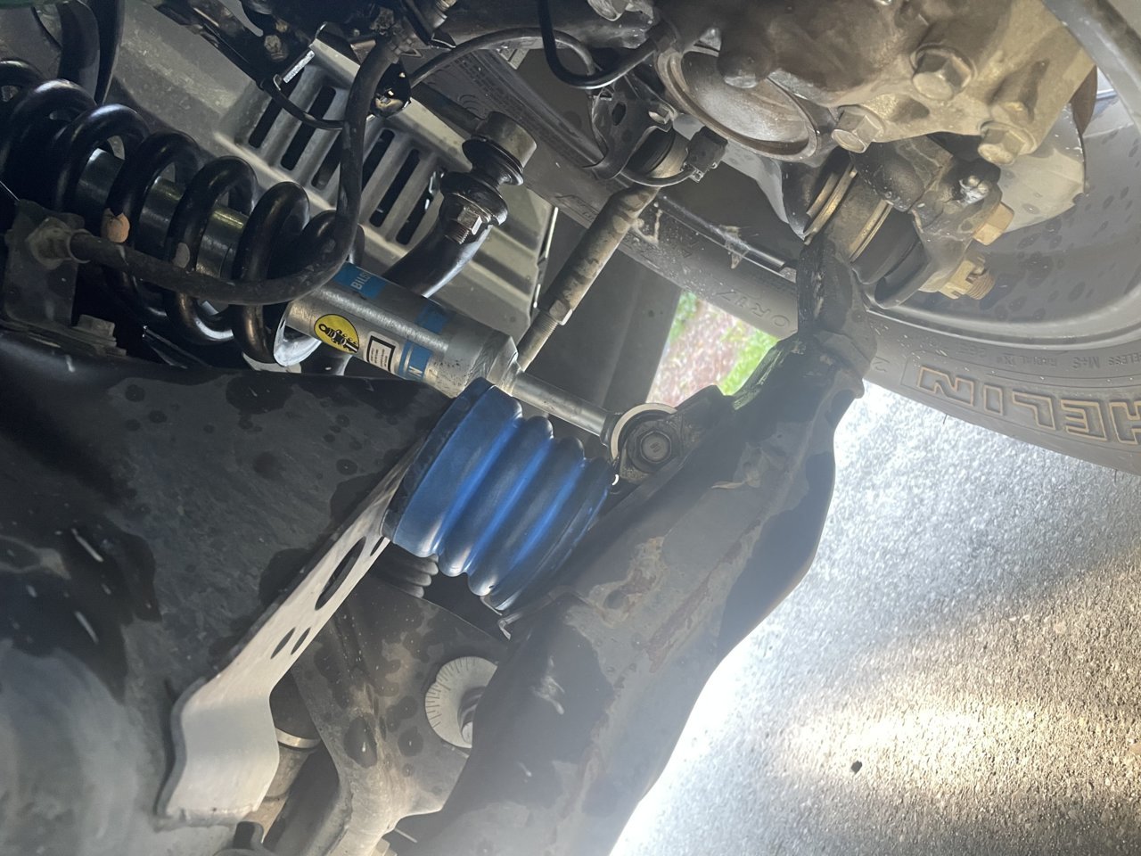

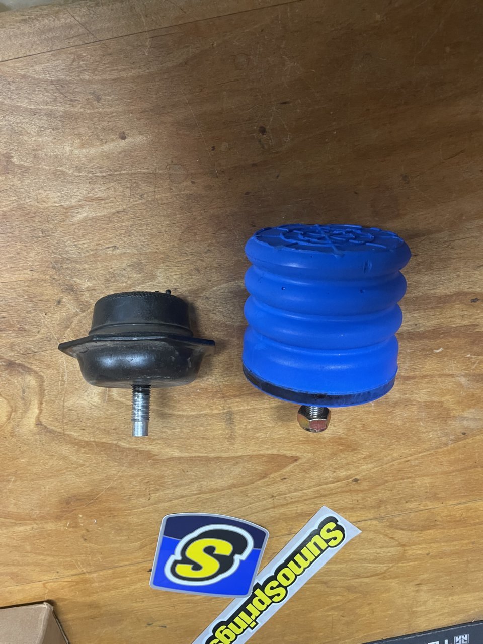

    Ordered Thursday, installed on Monday. Not bad
    They turned out better than expected. Bumps on and off road are muted and if you bottom out the suspension its not as jarring as with typical bump stops.
    Install was incredibly easy. It was a little pricy but I think it was worth it. Shout out to Sumo Springs for a great product
