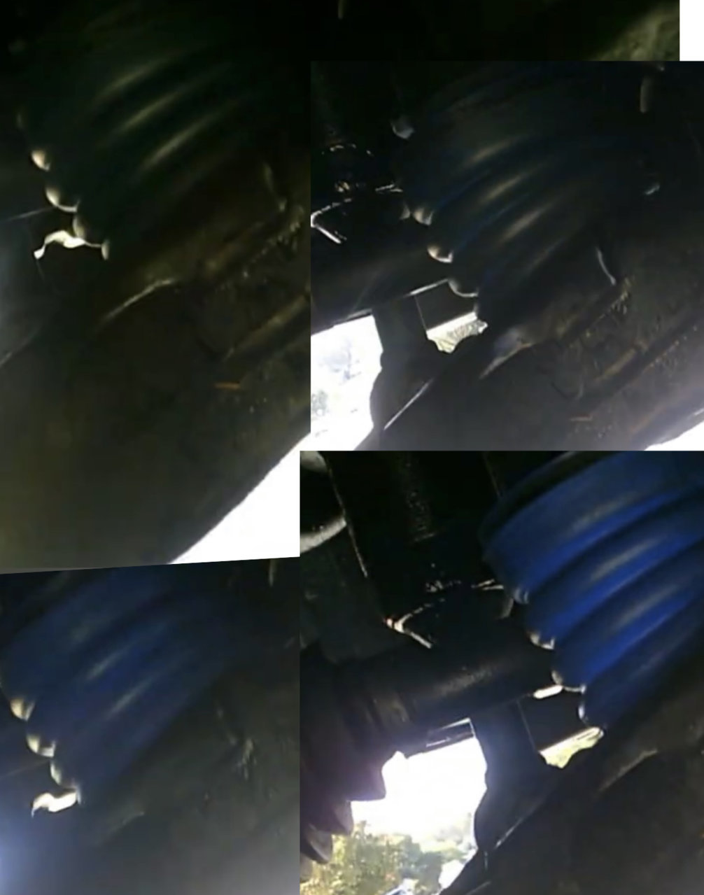

    Here my latest video, it includes a 1/2” spacer in there. I'll try and get time to get a few side by side pics of the compression at certain points in the drive. I need to find a better place to test it lol.

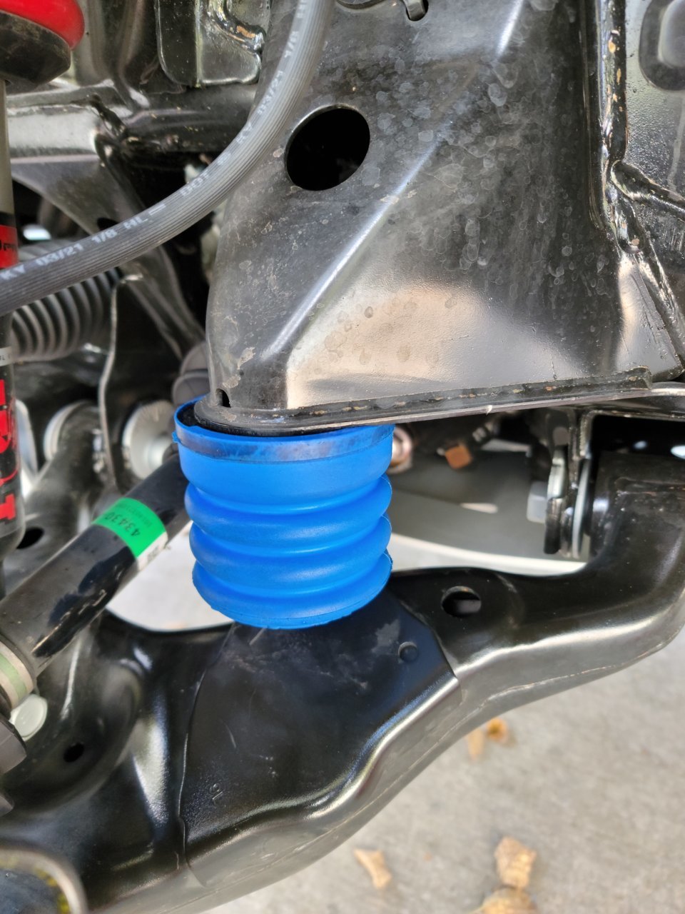

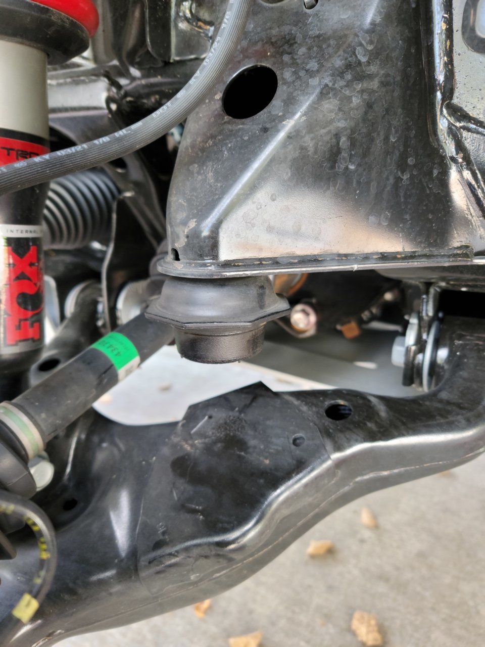

    Here’s some crappy pics I was able to get, top pics are with the spacer bottom are without. Both drivers side and as close as I could get to the 2 best compressions I found.

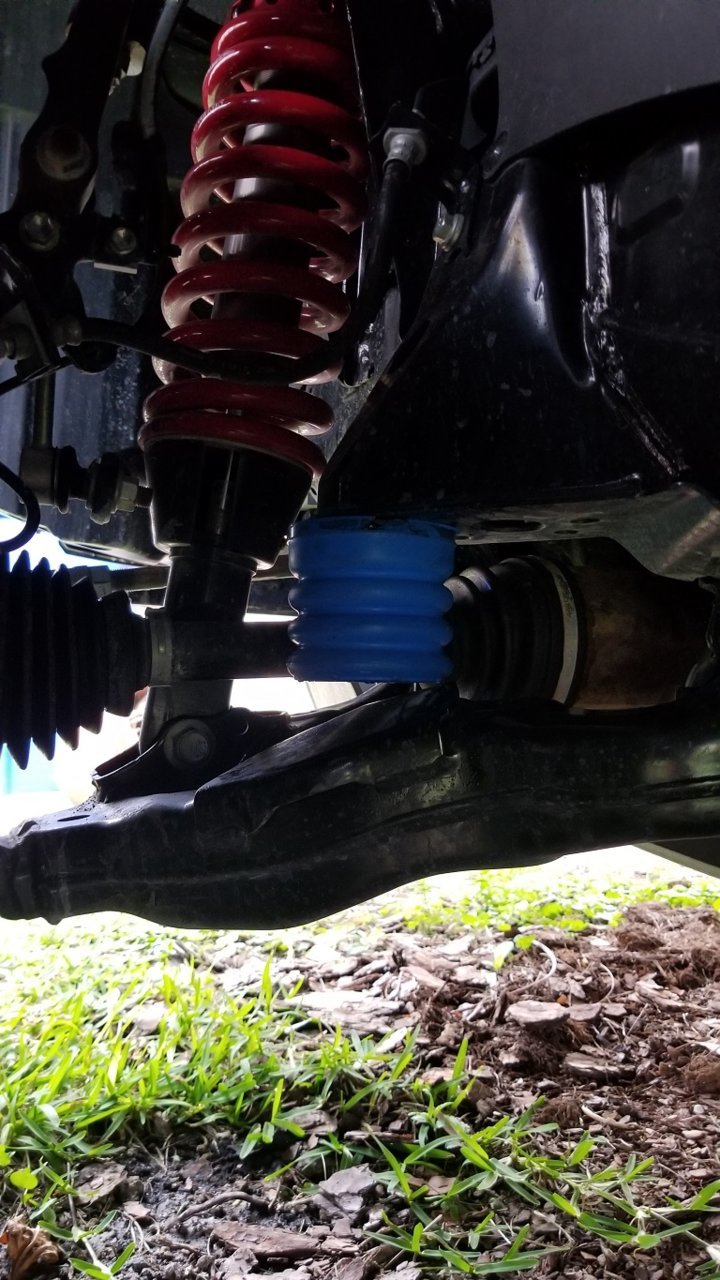

    FWIW - The rear bumps DO break in. When I first installed them they were quite a bit firmer than the fronts felt. Now a few weeks after install and a couple of loaded down camping/kayaking trips later, they are not nearly as firm on contact and at this point I really can't imagine driving this truck without bump-springs front and back.

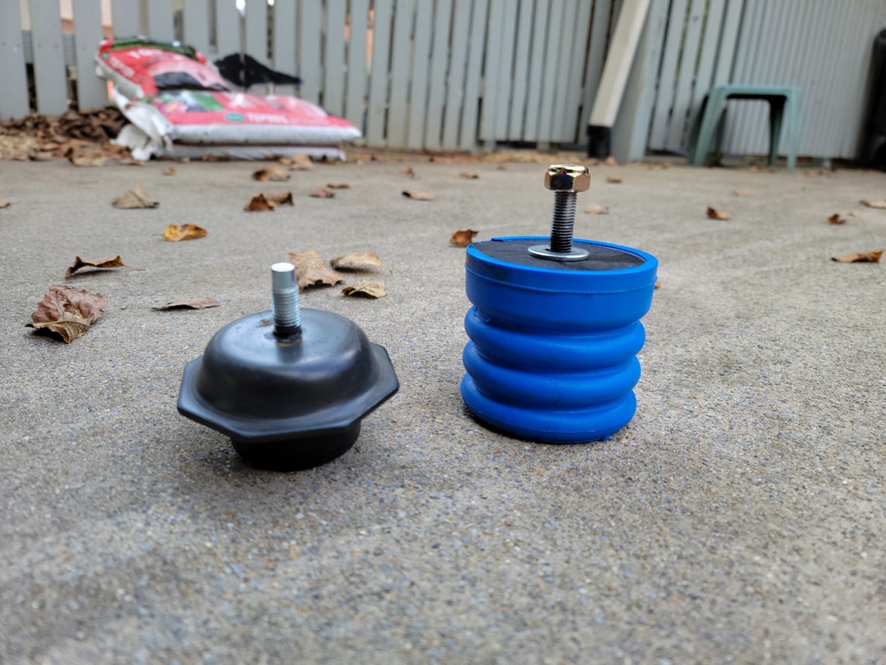

    Got them installed. Could tell the difference right away. 20211015_120603.jpg 20211015_121910.jpg 20211015_122334.jpg

    Here
    2017 Barcelona Red TRD Sport 4X4 Manual
    Pro grille, Black SEMA wheels, air dam delete. Rear Blue Sumo springs. Front Timbren Active off road bump stops. Bilstein 5100s front and rear.
    I swear the Tacoma needs these from the factory!

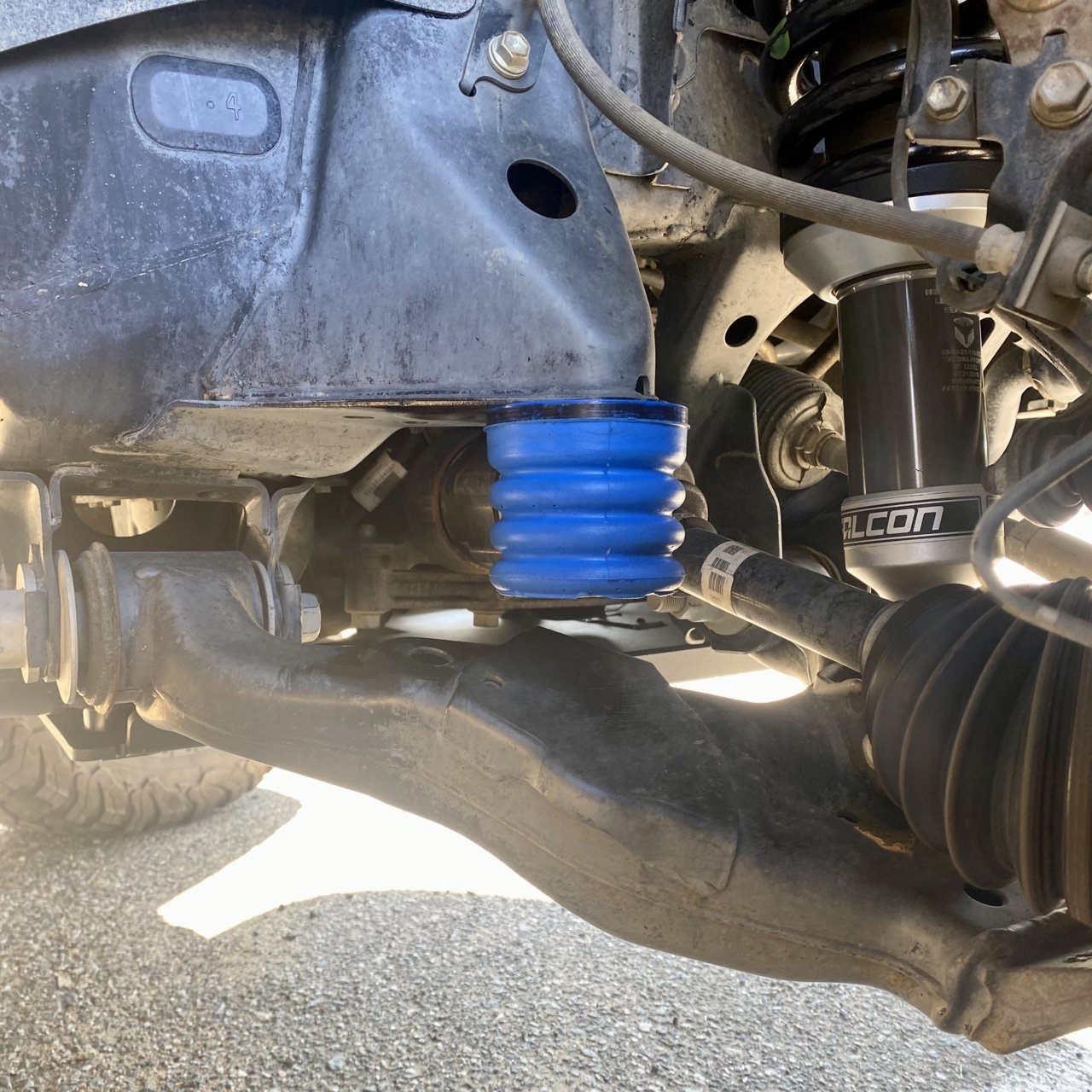

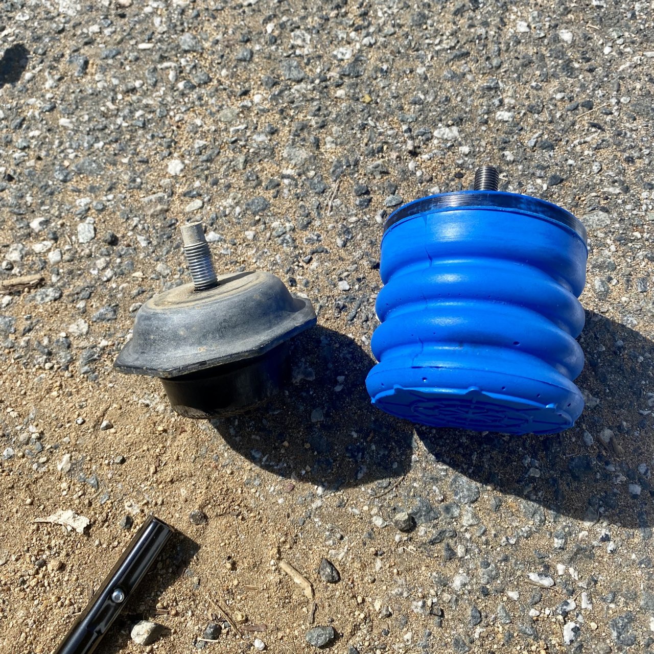

    ACBD9072-66DB-41E7-A1EF-2D985714A3DA.jpg 59A1BB48-9A12-42CD-B529-96FCDEAEAD4B.jpg
    Installed the front set yesterday, now have front and rear sumos, no complaints so far. It was pretty easy to remove the stock ones

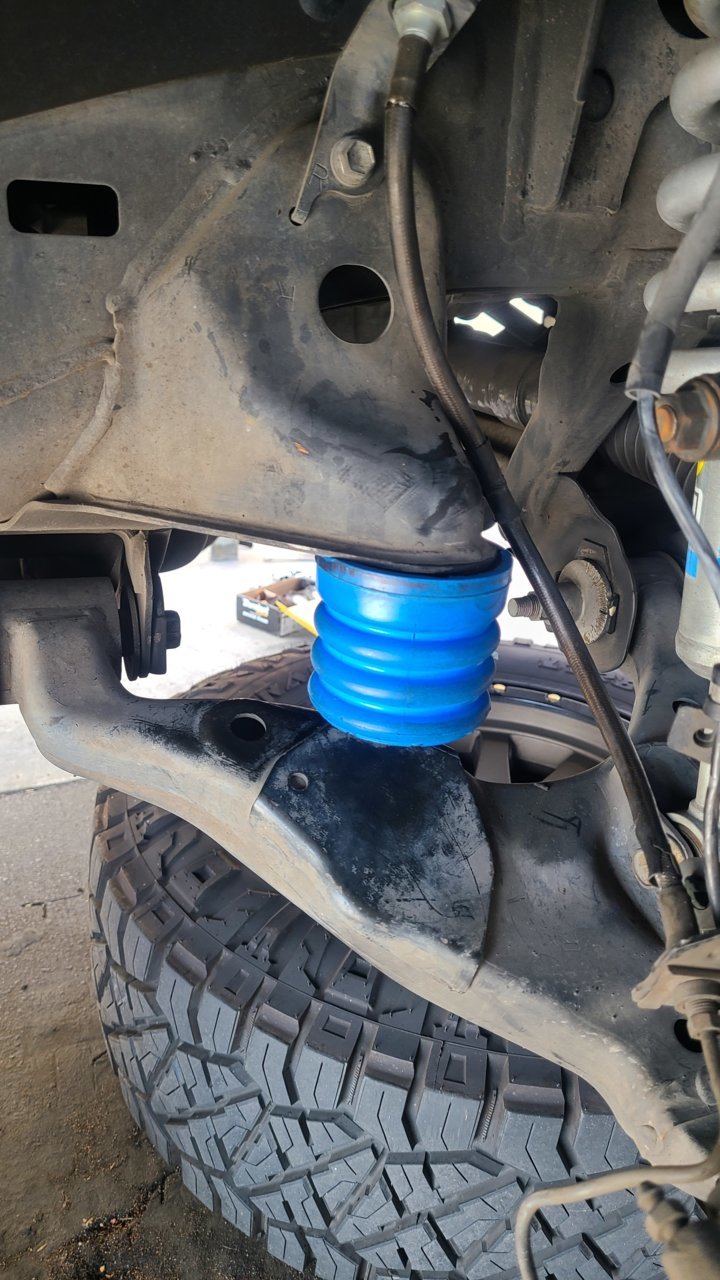

    Finally able to get a pair for the front. Really liking the ride. Had the rear for a year. I think the fronts would be tough to install stock height.

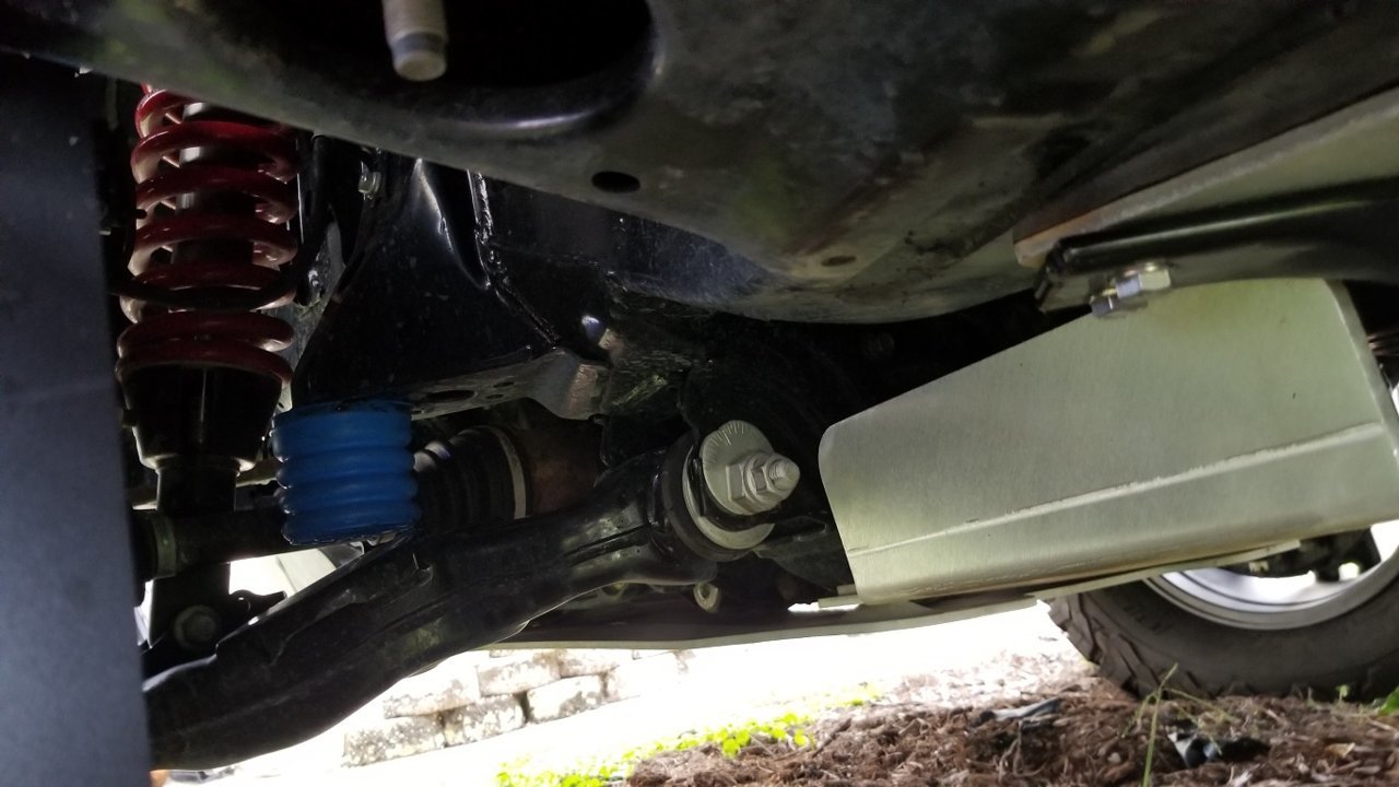

    Installed the front Sumosprings. They raised the front 1/2". From 34.25" to 34.75". Definitely reduced nose-dive while braking. Reduced some body-roll but didn't eliminate it. I think it made the steering lighter. Trying to stabilize the truck for towing a 3500# camper with a weight distribution anti-sway hitch setup.
    Had to cut off 3/8" of the bolt to get it in there. Instal with the cutting and filing took 50 minutes.
