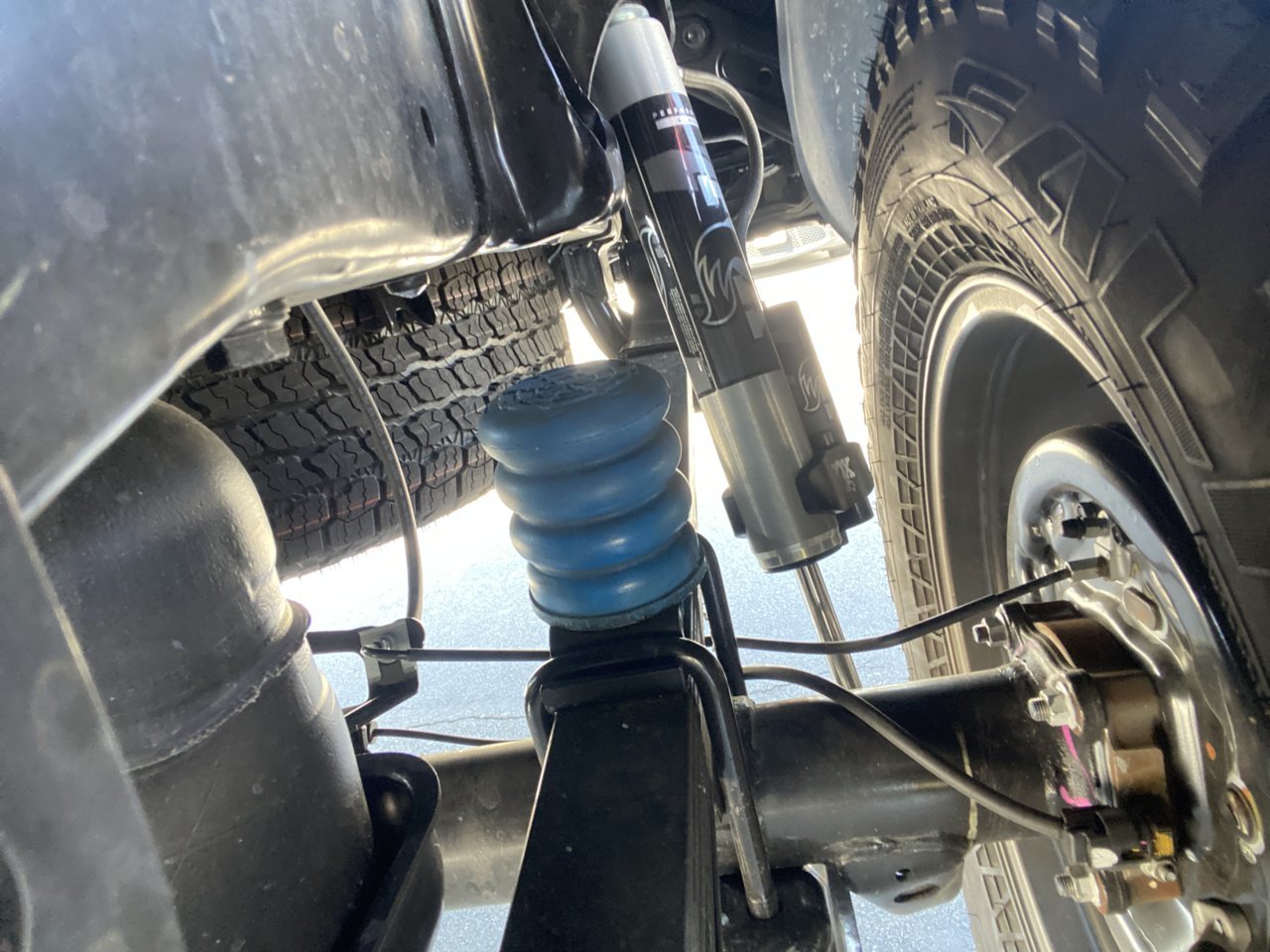

    Did the SSR-627-40 not SSR-612-40 in the rear since I added AAL for the additional lift when I lifted the overall fox suspension.

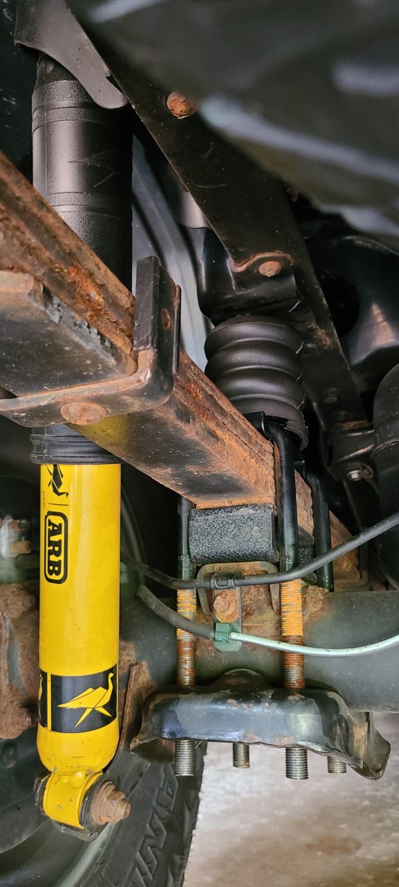

    I put some medium Sumos on the back with some medium OME Nitrochargers in hopes of stabilizing the slop in the back when going over bumps. It helped. Also helps support loads better. Picked up 6 sheets of OSB and it barely sagged, if at all
