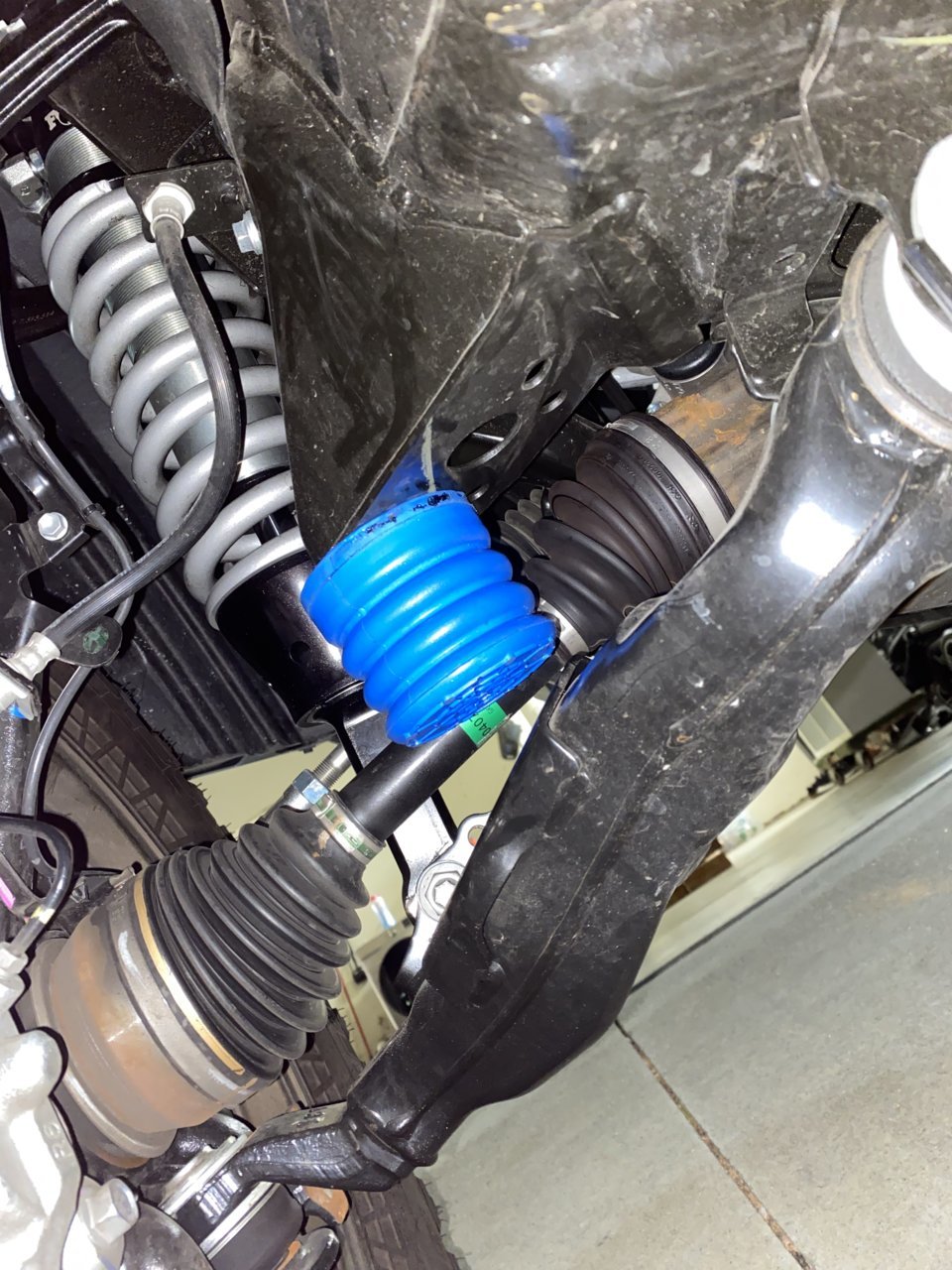

    If you’re not lifted it’ll probably be riding on the lower control arm. On my photo that’s with a 3” lift and as you can see it’s like an inch gap.
    the stud is 1” tall on the oem bumpstops.

    Hopefully it will ride nice with them resting on the lower control arms. I just measured the bolt on the Sumo springs, and they are looking to be exactly 1 5/16" in length.
    My rears also touch the frame at all times and also added a small amount of lift, about 1/2" or more if I remember correctly. I have double checked that I have the right ones, not the ones for the 2nd gen. I guess that bed mat and factory tonneau cover add just enough weight to make that happen. I can tell a difference with the rears installed. It is a little bit harsh at times. I may take the cover off just to see if there is a difference in the ride and if they are still in constant contact with the frame. The only reason I haven't so far is because I'm afraid my bed mat will end up getting stolen.

    My truck is stock height and I did not have to trim the bolt at all. Took a little elbow grease but I got them in without cutting.

    Yes the rear will ride stiff since you don’t have a lift and that means the leaf pack is closer to the frame. On my photo you can see I have a nice 3-4” gap between the leaf pack and frame but because I have a lift. You could add a ton of more weight to the back so it’s softer or just remove them if you’re not hauling anything. They take like 5 min to install or remove in the rear anyways
    fronts aren’t as stiff due to the weight of the motor. But it definitely feels a lot more stable with the front ones
