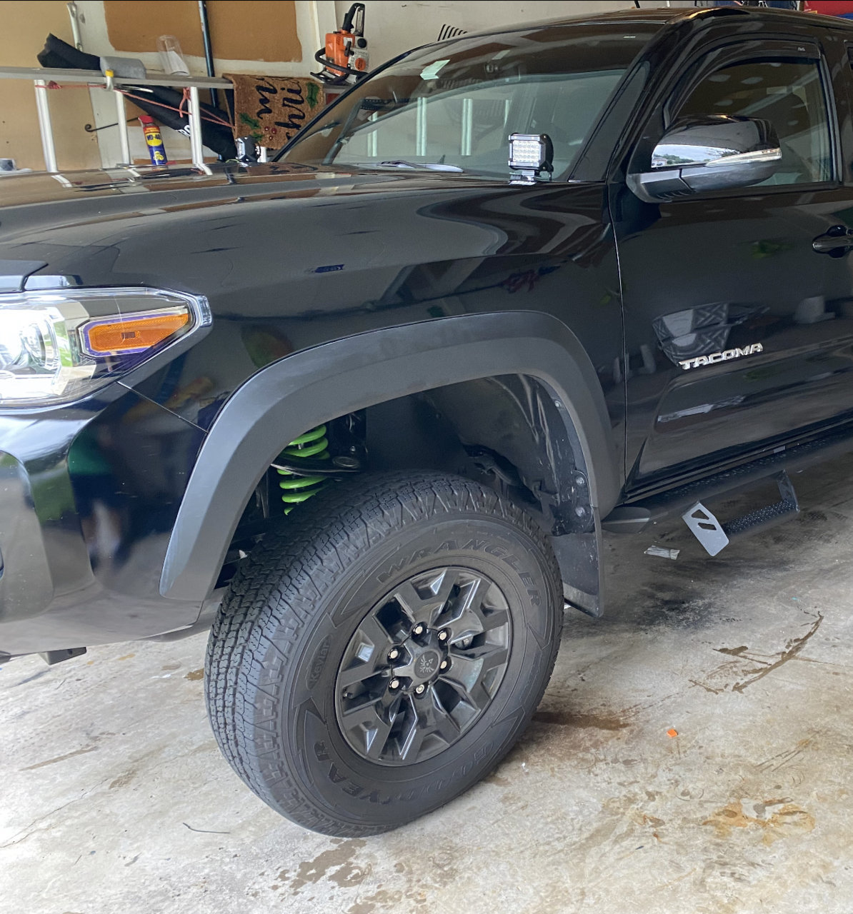

    Ironman Stage 1 Foam Cell Pro lift kit, 255/85/16 Cooper ST Maxx, SCS BR6 Wheels, SPC UCA, Heated seats, MESO TRD start button, Meso Total Tail v1, Meso V5 mirror white DRL turns, bed decal, ditch and hidden bumper lights, screen protech, RAV4 radio knobs, steering wheel anytime camera kit, dash cam, ECGS bushing, Timbren Active Off Road bump stops with Wheelers flip kit. 35% Xpel CS Ceramic Tint, KD Max Tune, SumoSprings front bump stops, RRW Sliders ‌ ‌ ▲ ▲‌ ▲
    Maybe if I end up swapping my Ironman Springs for King springs I could use these unless I get another set sooner. I don’t think the green springs would go well with these blue stops. I do like that they will contact sooner than the competition.
    Ironman springs are green and while they look good on my truck, I can’t really add other colors lol. Not that those bump stops would normally be visible
