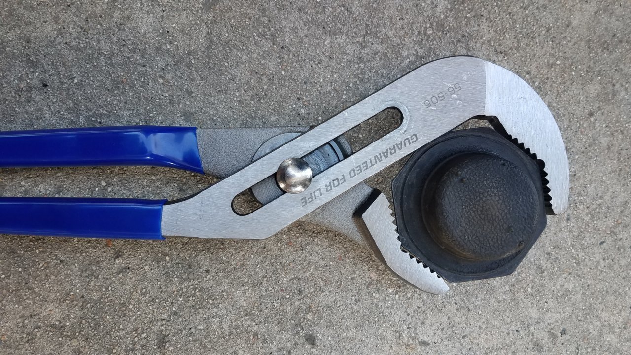

    I just took the front wheels off and used a large pair of Channel lock pliers to get the old ones off. Used the blue loctite and screwed the new ones in like a light bulb. Ez Pz.

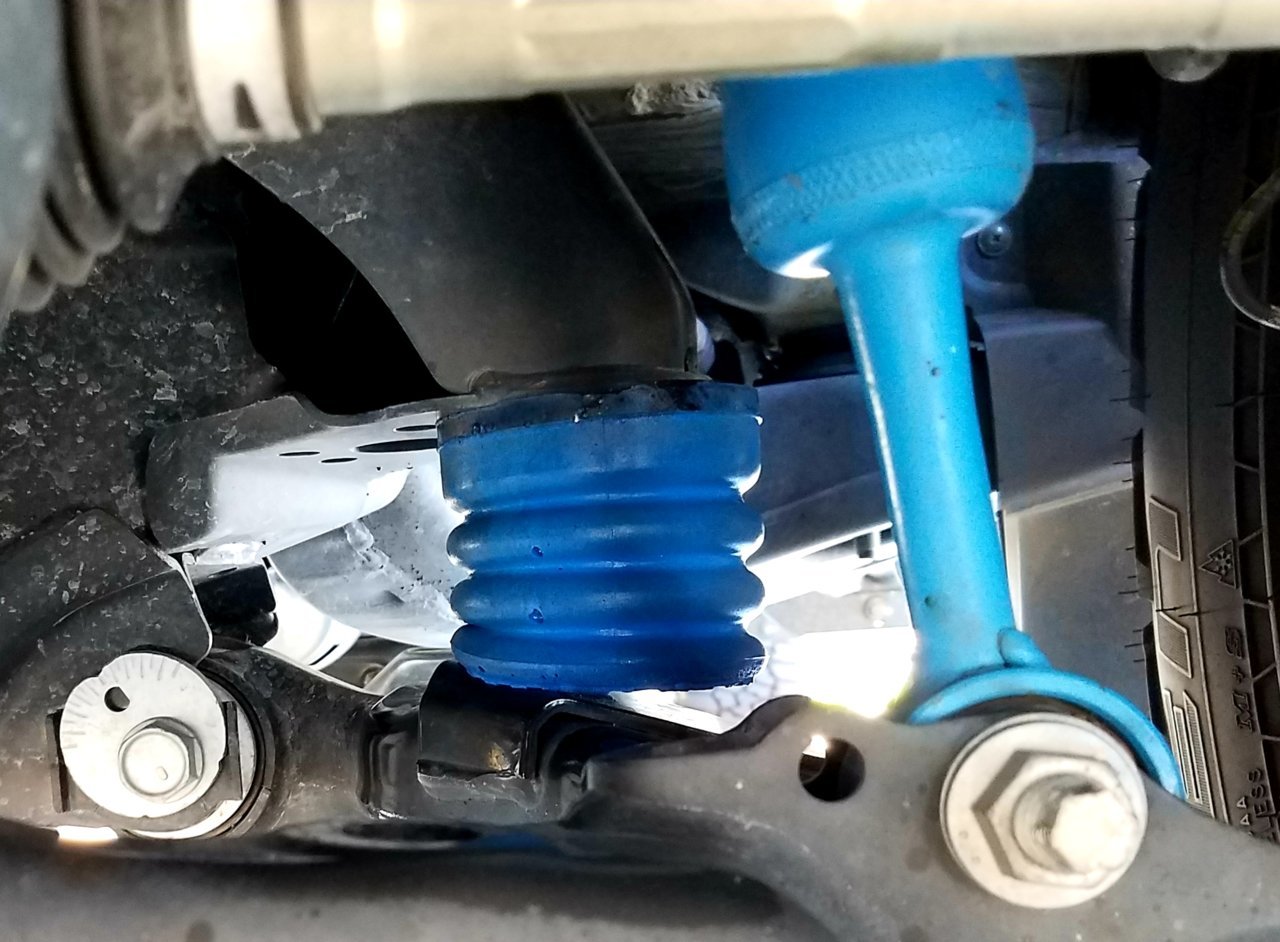

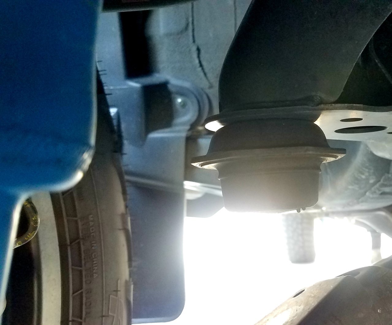

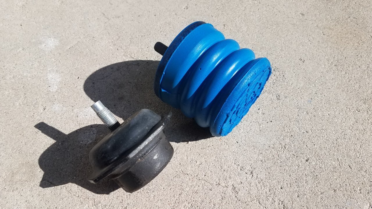

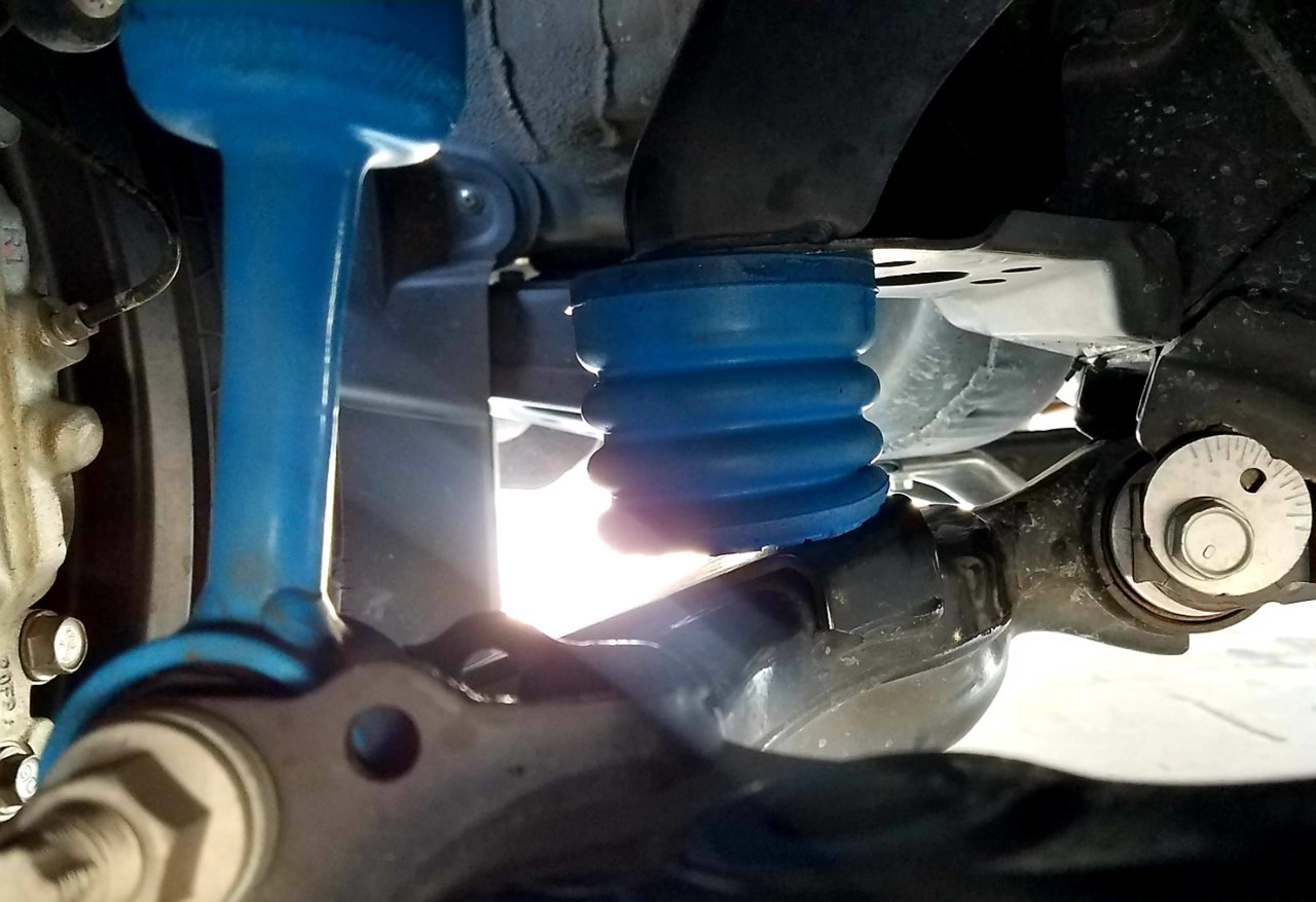

    Put mine in today, pretty easy job even with the tires on, but I was afraid of cross threading them because I had to squish them in there a bit in order to get them all lined up properly.
    All went well though, no cross threading, and on the test drive I did notice right away that all the potholes and manhole covers on my usual route didn't seem as intense as they used to. :thumbsup: I really like the feel of these. It is an improvement. My Sumo's do slightly keep constant contact (2020 SPORT stock suspension, no lift) but my front end ride height remained the same. Very happy with these, thanks again OP!
