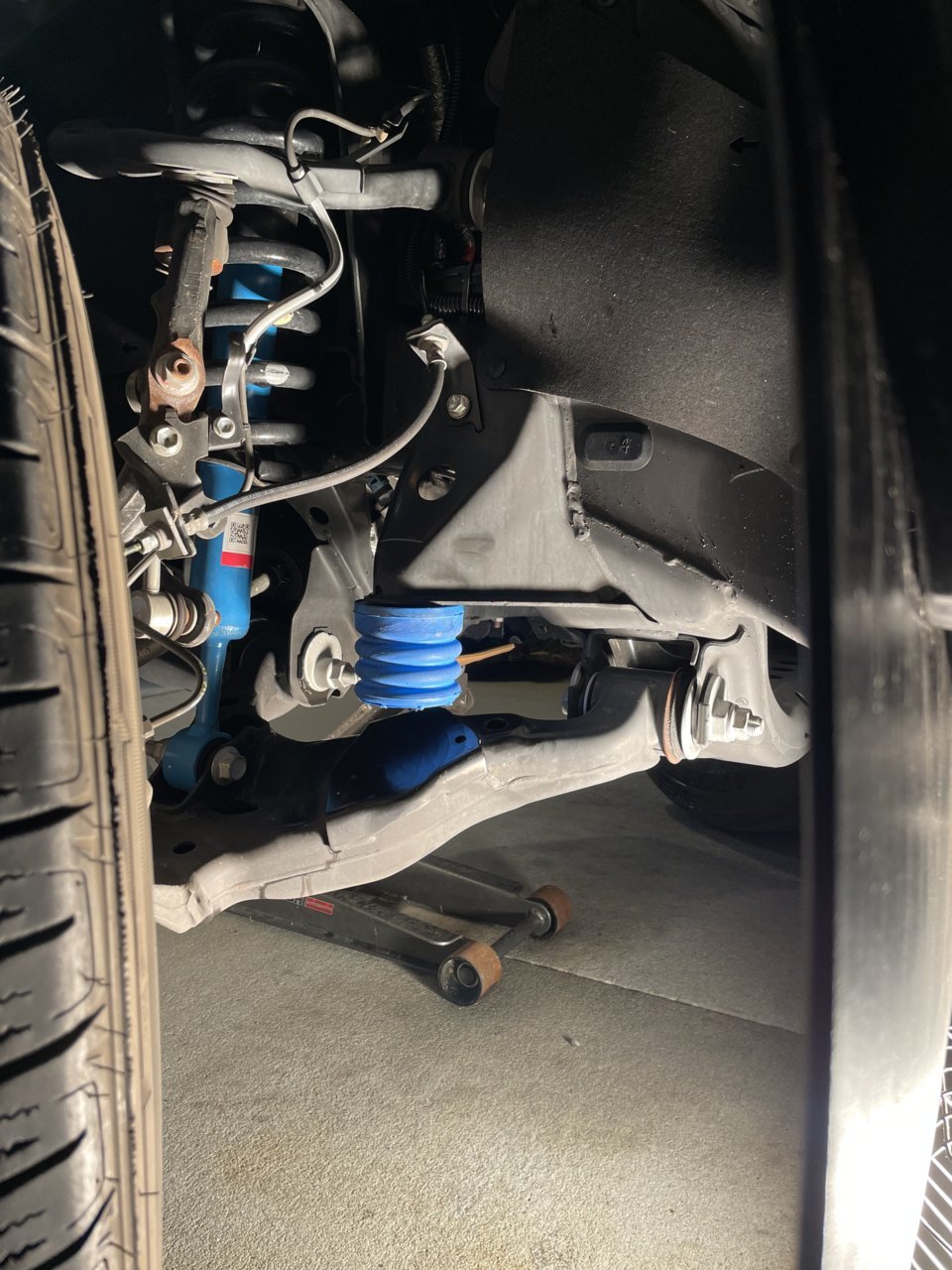

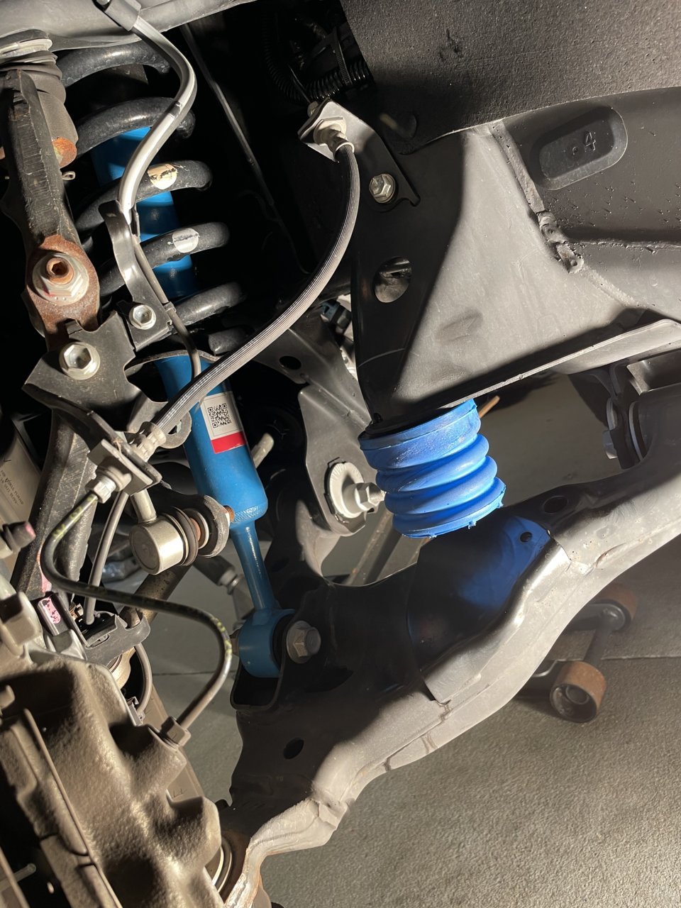

    So got mine installed and with the longer threads, stock height it was a tight fit to squeeze it in and thread it without cross threading. I didn’t want to take the chances and I also didn’t really feel like removing the lower shock and end link but that would probably be best.
    I cut the stud down to an inch and it was still tight but once I got the angle correct was able to slowly thread it on holding it in that position (thread the stock bump back on to visualize angle, it’s not exactly perpendicular to the frame but slightly angled back). I still have 1/4” threads past the nut after cutting them down. Drivers side has slightly more contact (firmer) while the passenger side does touch but more sweeping. I did paint the tips of the studs after cutting.
    Have not taken it for a ride yet being it’s late.

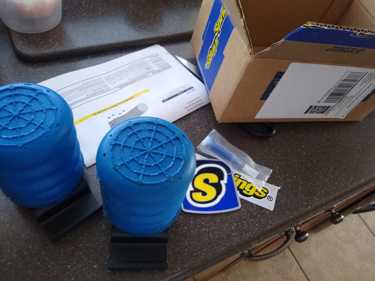

    Bam!!! Ordered yesterday and Amazon just dropped the rear bump stops off. Got them in about 24hours, Shazam!IMG_20210912_161947178.jpg
