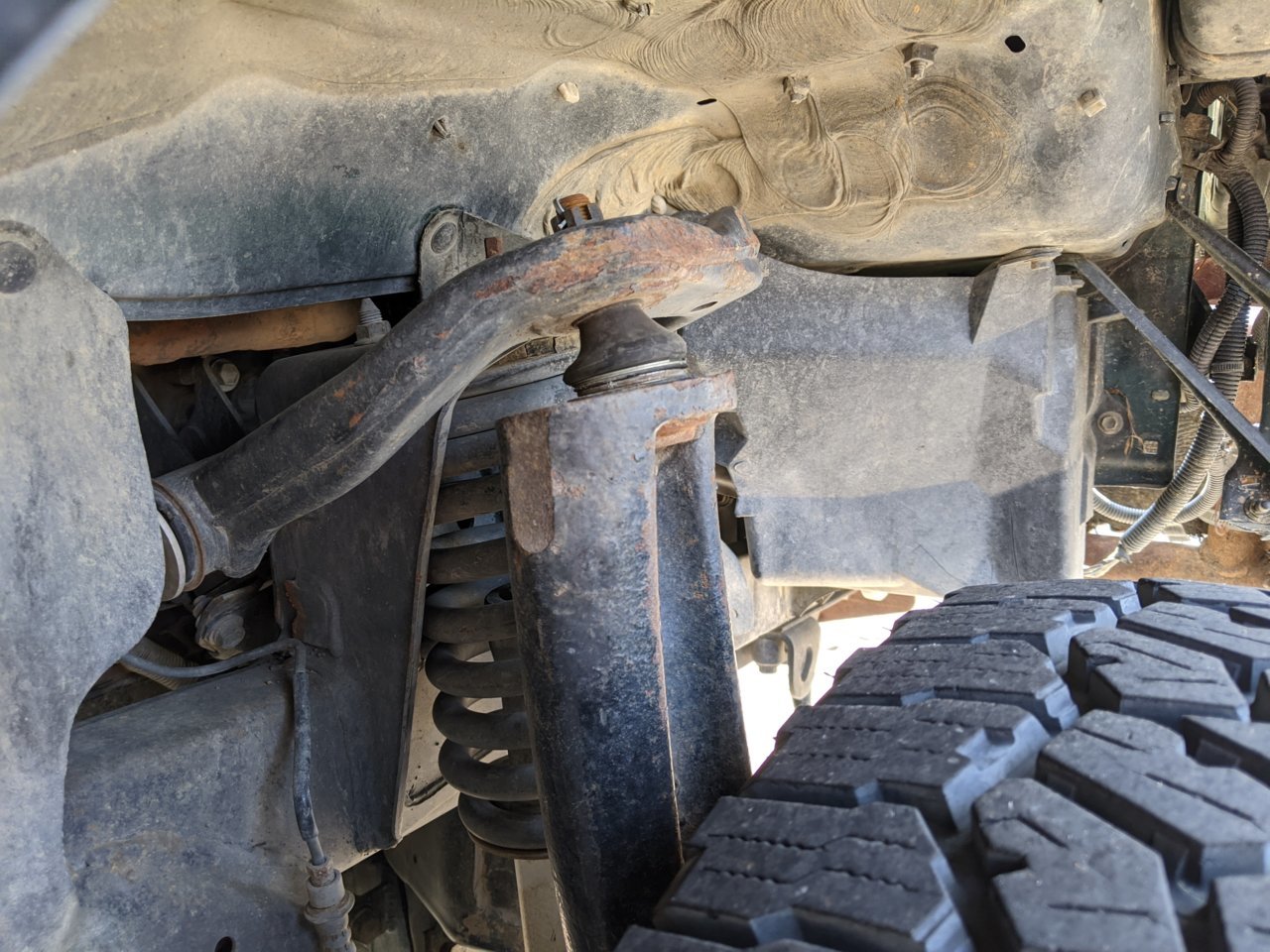

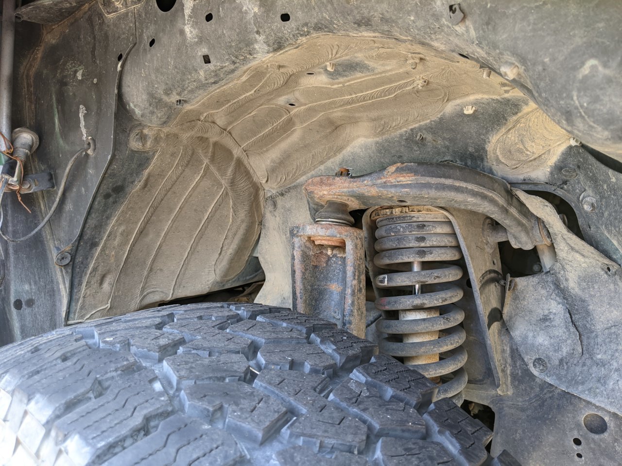

    hey, i've got a 2002 tacoma with 6" fabtech lift (lift was on it when i bought it). i recently noticed that the upper control arms are pointed up (not flat or down like ive seen on most trucks) and i'm about 1/4 inch off the bump stops so i'm constantly hitting them. my rear leaf springs are pretty flat as well. but the truck is still level. is this something that just happens over time? 140k miles on the truck. my first thought is new struts? but would i also need new springs? stronger springs? maybe a heavier duty leaf kit? i've went to a couple shops and asked but they weren't much help. any thoughts would be much appreciated

    Suspension components wear out and need to be replaced. Looking at your coils I’d say that’s the case here. The upper coils being in a tighter formation and almost touching is an indicator of a worn or possible broken coil. If your leafs are flat I’d say it’s time for a refresh all around.

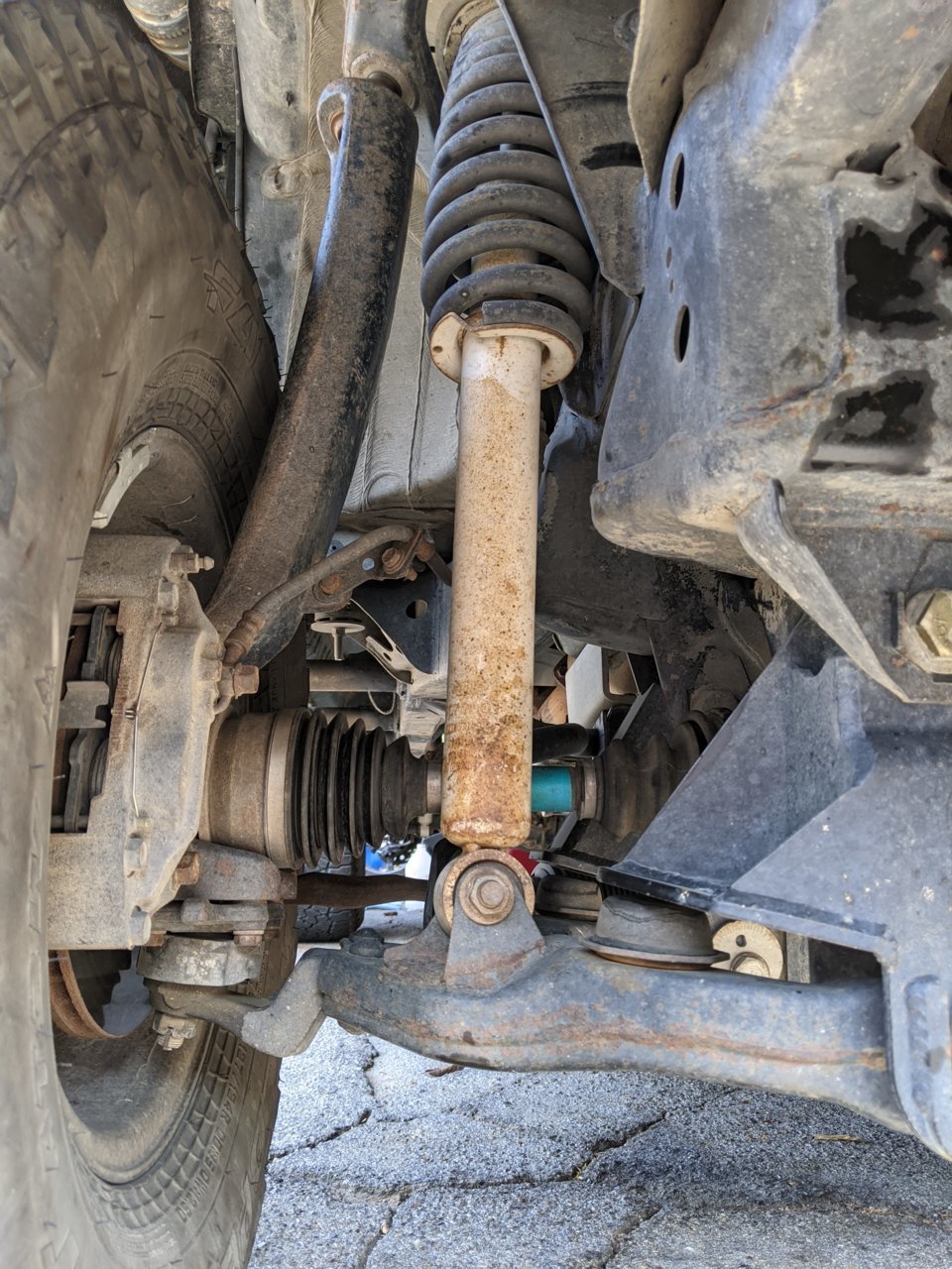

    The upper control arms look upside down, the coils are worn out, the front shocks don't look straight - like the piston shaft is bent... and so on.

    That is definitely not right. Dont know much about 6" lifts but your UCA should be almost closer to level as you mentioned and LCA at a slightly downward angle. Almost looks like wrong or weak coil springs.

    Well, seeing that your CV axles are pretty much horizontal to the ground, you could remove the Fabtech drop bracket lift, put the truck back to stock suspension parts and then just install new and cheap Bilstein shocks, new coils and you'll have the same lift as you currently do - which should be the "level" you seek.

    Okay man, so it looks like the suspension is missing the 4” or 6” spacer that goes on top of the coilover. If it’s a 6” in, you are for sure missing the spacer. Look around on the forum for the DB lift thread and compare. It might be different for the 1st gens, but on the 2nd gen setup, you can swap typical coilover packages with the spacer in place as it makes up for the bottom bracket dropping the LCA. If i can find pics, I’ll post.

    Look how long the strut is my dude
