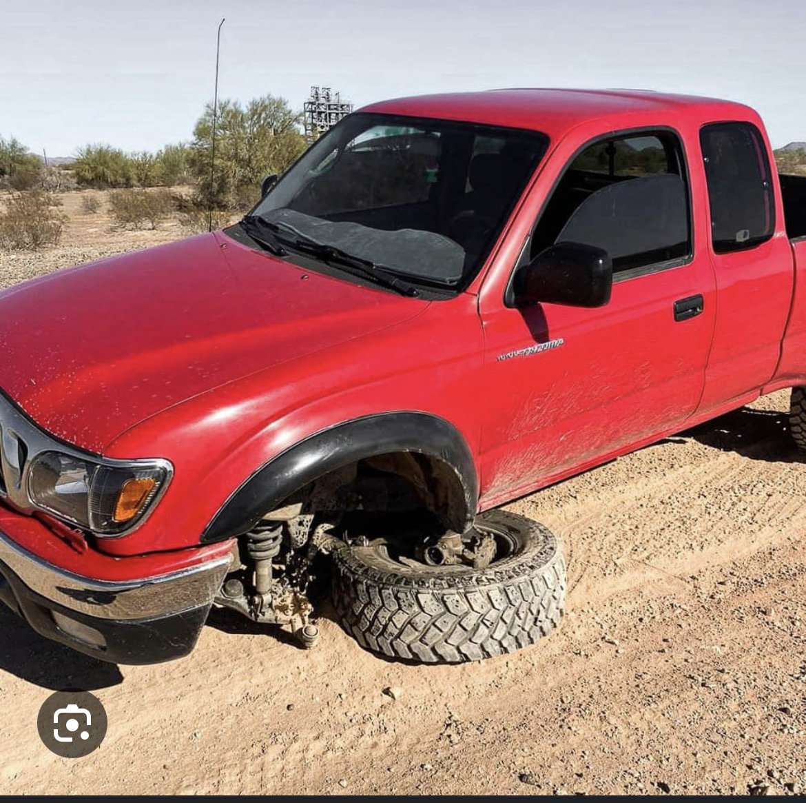

    Typically you hear that a few hundred miles before this happens…

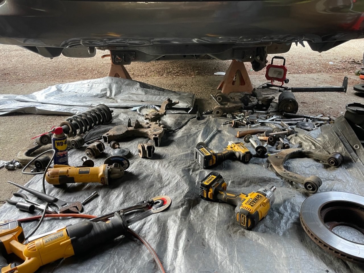

  9. Oct 31, 2023 at 8:35 AM
    Red_03Taco
    Red_03Taco Well-Known Member
    Nov 2, 2021
    #381170
    1,609
    Jerad
    2003 Tacoma Xtra Cab 4WD

  17. Nov 3, 2023 at 12:40 AM
    #17
    Diablo169
    Diablo169 ROKRAPR
    Mar 12, 2016
    #181079
    2,908
    Max
    Santa Cruz, CA
    99’ Bro-Coma’s Revenge 3RZ 345k+
    Stock
    That’s literally not possible with Toyota bushings unless they have failed.
    The metal sleeves have teeth that bite into the bracket that doesn’t allow them to spin. The bushings are installed dry.
    The only things that really squeak/ creek are the ball joints. I’ve seen Moog ball joints fail in 15k miles.
