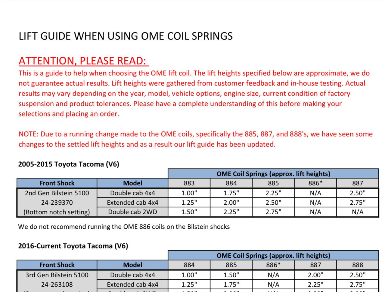

    Welcome to Tacomaworld! Bilstein 5100's and an OME 88x coil will suit you well. Use the chart to see how much lift you want and then compensate for the added weight.

    Here is the chart :thumbsup:
