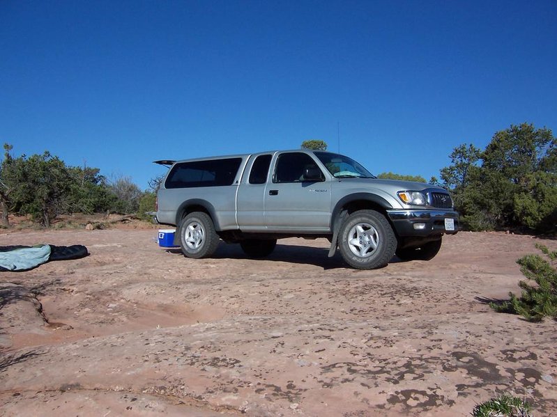

    Hi, I got my 2004 new and just replaced the engine at 300,000+ miles.
    she is silver and took us on many adventures, and back.
    I just had a remanufactured engine (LKQ) installed and now the front end feels
    loose, sloppy, may not be the correct term to describe.
    I have changed out the struts a few months ago and something inside the steering column. Everything else is still stock.
    Does anyone have any info on what will tighten things up?
    Maybe upgrade things, not for racing, basic off roading.
    Thanks

    Nice Tacoma!

    Great looking truck! Hopefully you get the front end issues figured out!
